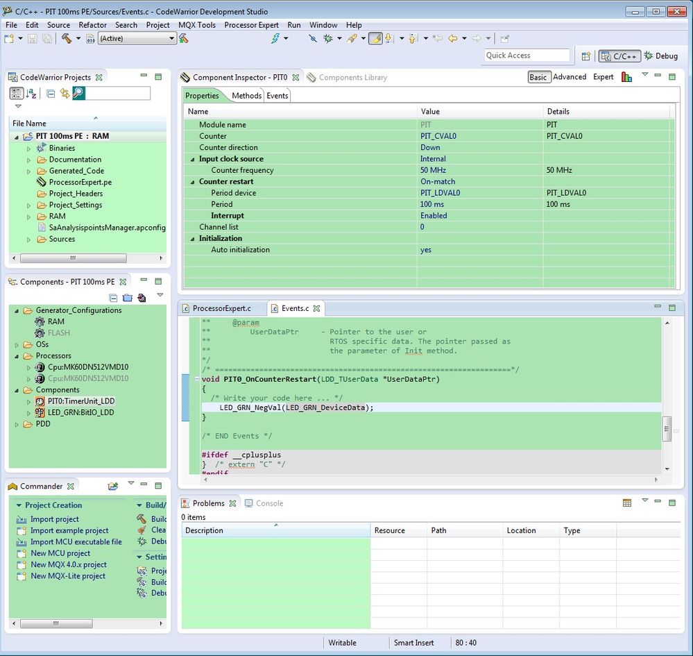

I have a k60 development board, and now want to use the codewarrior implementation produces a 100 ms interrupt timer, how should I set?
Development board type:TWR-K60D100M

You can refer it:
2,759 Views
Robin_Shen
I generate a project using CodeWarrior10.5 with PE.
Use the TimerUnit_LDD as PIT , every 100ms it may run into PIT0_OnCounterRestart at Event.c.
Use the BitIO_LDD as LED_GRN , every time it run into PIT0_OnCounterRestart ,  the green led will change it's status.

There are several module you can use to do that.
Maybe you can use PIT module.
