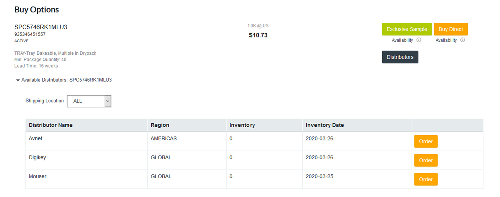

We bought the board of MPC5746R-176DS,  but the marking of IC on the board is SPC5745RMLU3, NOT SPC5746R.
Pls check the attached pictures for details.
Pls help check if we received correct board, thank you.

Yes you received correct board. However the micro has different markings.
There are some differences in those 2 variants of micro.
I can recommend you to return the product to the vendor. Or just purchase /sample the MPC5746R device.
Which costs 10$:
SPC5746RK1MLU3 Product Information|NXP
The MPC5745R will work correctly in the EVB. As the EVB is suited for all versions of MPC574xR devices.
