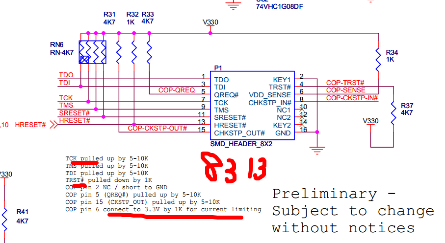

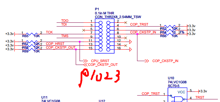

hello,I found some differences in JTAG connection between P1023RDB and MPC8313ERDB schematic,see picture below. Does it means my USB TAP(REV F) for MPC8313ERDB don't support P1023??

yipingwang
Hello longqi luo,
USB TAP can be used fro both MPC8313 and P1023.
Would kind of error did you encounter?
In CodeWarrior 10.5, there is JTAG diagnostics function, please enable it and check whether there is hardware problem on P1023 custom board.
