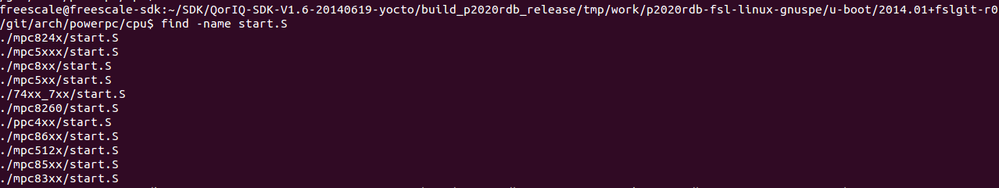

We've recently compiled "Das U-Boot" with gcc 4.8.1 for powerpc target and debug by CW using a elf file.
After reference "AN4876:CodeWarrior U-Boot Debugging.pdf" and "Targeting_PA_Processors.pdf", we can debug u-boot from setpicloadaddr 0xfff40000 (768K).
However, it shows that the file "start.S" can't be find under "QorIQ-SDK-V1.6-20140619-yocto\build_p2020rdb_release\tmp\work\ppce500v2-fsl-linux-gnuspe\libgcc\4.8.1 fsl-r0\build".
Truely, we don't have any files under that path.
Is any process we miss???
Thanks for your response.

There are start.S in the path:
QorIQ-SDK-V1.6-20140619-yocto/build_p2020rdb_release/tmp/work/p2020rdb-fsl-linux-gnuspe/u-boot/2014.01+fslgit-r0/git/arch/powerpc/cpu

kuoweihsu
Hi, lunminliang,
We found that the path "QorIQ-SDK-V1.6-20140619-yocto\build_p2020rdb_release\tmp\work\ppce500v2-fsl-linux-gnuspe\libgcc\4.8.1 fsl-r0\build" is wrong by some reasons and talked about this issue in this link
U-boot debug failed because "Can't find a source file"
