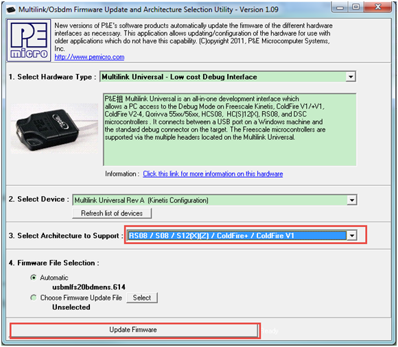

MULTILINK  UNIVERSAL无法再CW6.2、CW6.3上面使用,之前用的Rev.B能直接使用,现在用的Rev.C不能用了。

Hi Duan,
I suggest update to the new firmware that was released on Dev,4.
http://www.pemicro.com/downloads/download_file.cfm?download_id=346
USB Multilink Universal Resource CD (10275 KB)
don't forget use firmware updates tool to update the firmware.
for example, if you work with 8/16bit MCU, you need udate firmware to support RS08/S08/S12(X)(Z)/…, see below screenshot:
If the target is PPC5xxx, choose setting as:
  Can this help you solve the problem?

Hello Damon
Please install the latest patch on CW6.3 and update with the latest firmware for Multilink Universal:
http://www.pemicro.com/faqs/faq_view.cfm?id=211
