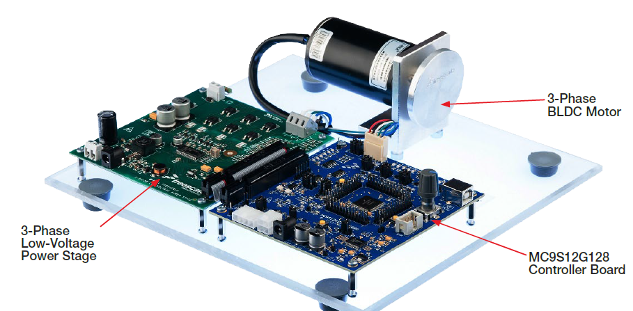

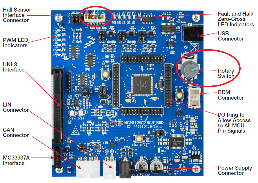

We did connect the hall sensor connector to JP1 of this development kid MTRCKTSBNG128.  We use Free Master and go File/open project, select BLDCHall9S08\MC9S12G128_BLDC_Hall.  We pressed the rotary switch to start the motor, but motor didn't start, the motor is originally included in this development kid MTRCKTSBNG128 (see second picture below).  Please also see Hall sensor Connector and Rotary switch cycled in the first picture below.   In Freemaster screen, we click On/Off button, the motor didn't spin.  We noticed on Freemaster screen, requiredSpeed showed 30,000+ rpm as a default speed, then i changed it to 3000 rpm, motor still does not spin.
