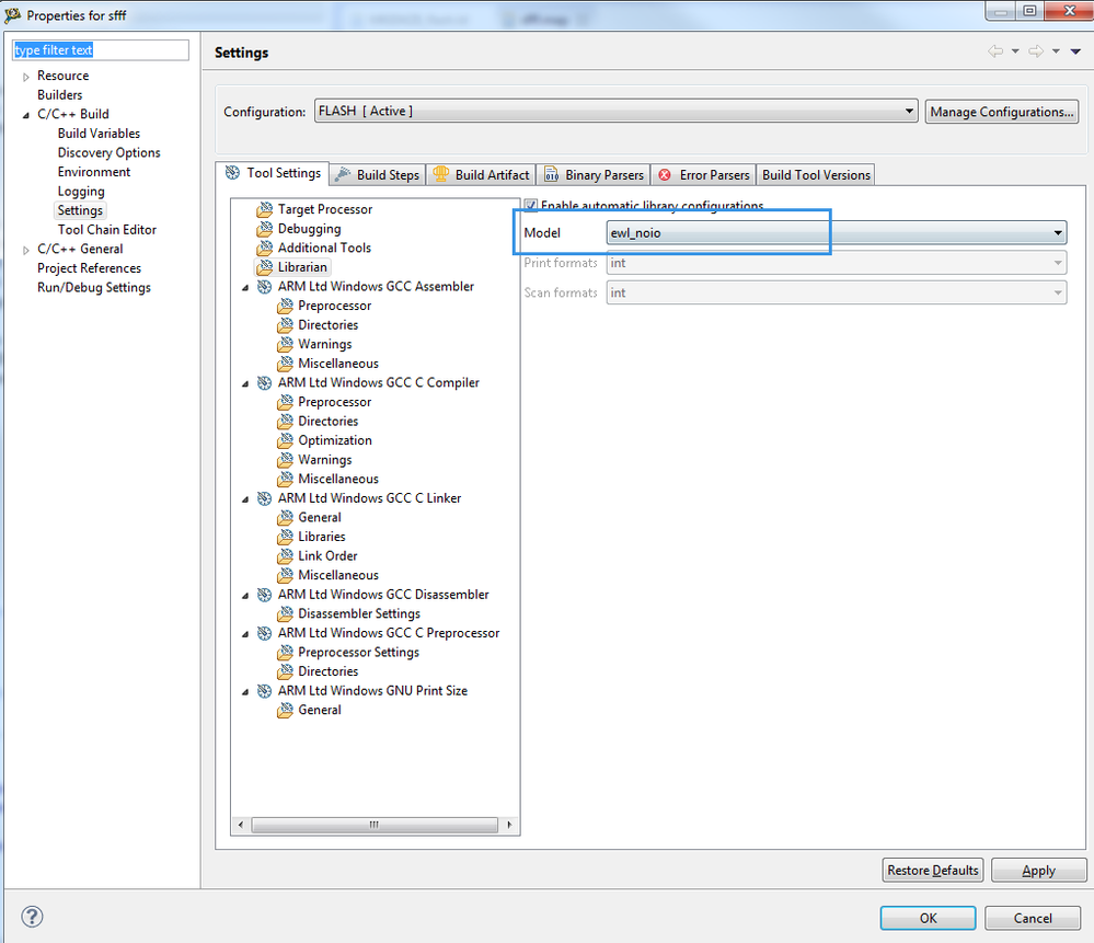

IlConte
I use CW10.6
The problem is that using KE04Z8 with only 8K flash, using ewl and example libriray the flash space remaning is very low.
In particular using the standard ewl library i have the map with this occupation
.text.long2str.isra.0
                0x00000a44      0x19c C:/Freescale/CW MCU v10.6.4/MCU/ARM_GCC_Support/ewl/lib/armv6-m\libc.a(printformat_.o)
 .text.__pformatter_
                0x00000be0      0x428 C:/Freescale/CW MCU v10.6.4/MCU/ARM_GCC_Support/ewl/lib/armv6-m\libc.a(printformat_.o)
                0x00000be0                __pformatter_
 .text.__sformatter
                0x00001008      0x698 C:/Freescale/CW MCU v10.6.4/MCU/ARM_GCC_Support/ewl/lib/armv6-m\libc.a(scanformat_.o)
                0x00001008                __sformatter
 .text.isalpha  0x000016a0       0x20 C:/Freescale/CW MCU v10.6.4/MCU/ARM_GCC_Support/ewl/lib/armv6-m\libc.a(ctype_aeabi.o)
                0x000016a0                isalpha
The ewl library use many flash space condering only 8K flash max (0x2000).
The space left for the application is really too small !
I hope there is a simple solution for this problem, otherwise it is almost impossible to develop.
What library setting can I change?
Which solution do you recommend to work with this processor?
Thanks all !

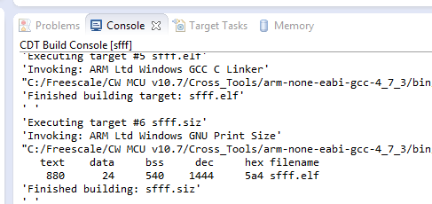

Hello Stefano,
You can use the library of ewl_noio:
the used flash size is 0x5a4 :
Hope it helps
TIC
3,700 Views
IlConte
OK !! Solved using ewl noio  !
