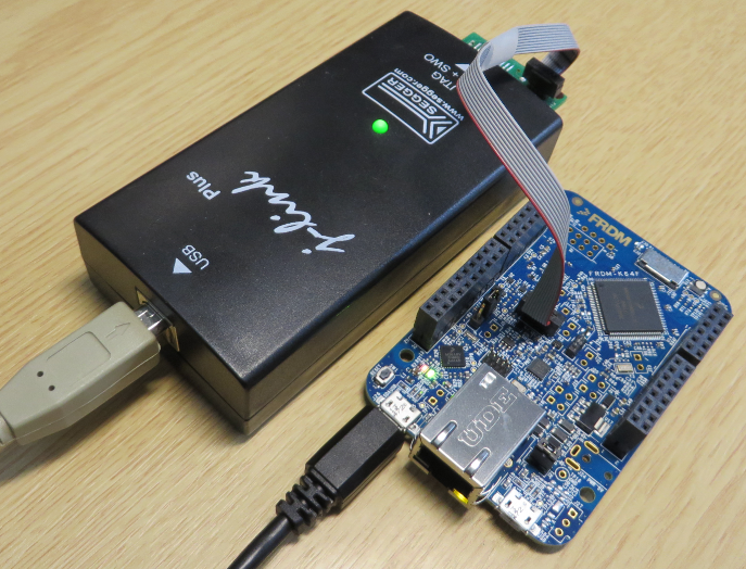

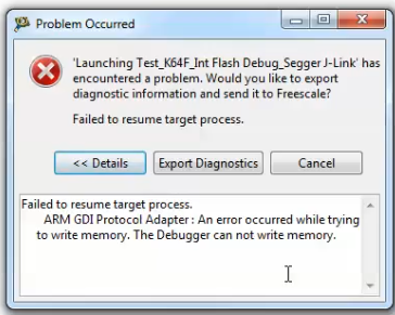

Hi there,
Trying to get running a MQX 4.2 project (from scretch) on the FRDM K64F and I'm failing permanently!!
Setting up an example works very well (see following link):
K64F Hello2 Example - YouTube
Setting up an MQX 4.2 project from scratch fails for the K64F plattform:
K64F MQX from scratch - YouTube
I tried the same procedure on the TWR-K60D100M and it work just well. So why doesn't it work that way for the FRDM-K64F
Thanks for any help!
Cheers Nik

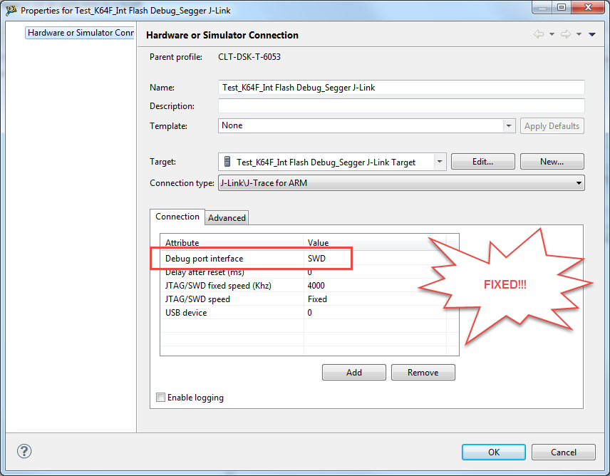

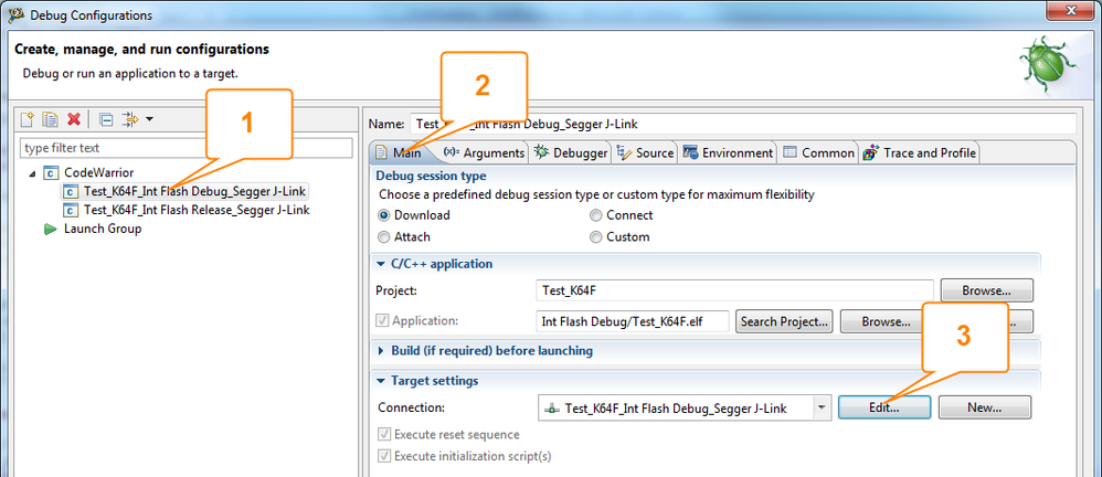

Solved that way:
Go into the debug configurations (follow the figures) and make sure that the "Debug port interface" is set as "SWD" and not "JTAG"!
Thanx Alice_Yang for providing the essential hints!!

Thanks for responding.
Following the Error Message that occurrs:
Yes, that example works. I tried to download "Hello" and "Hello2" example and they work well. But trying to download my own project fails, popping up the error message above

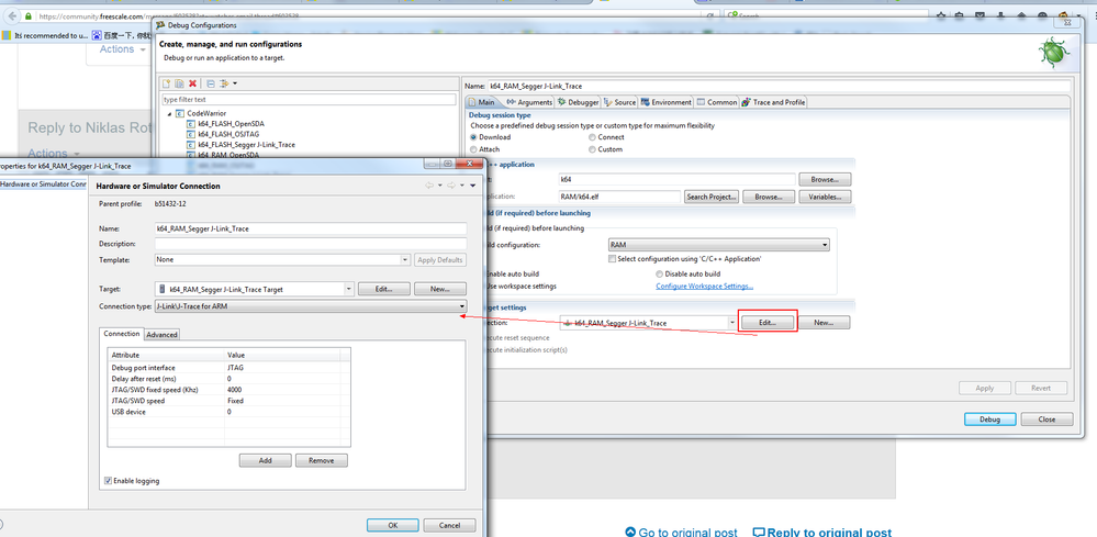

Hello Nik,
- I create one simple bareboard  project about k64 , then use the J-link debugger to flash , it also show the error
as yours .

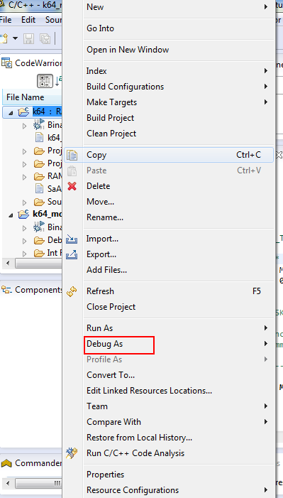

And when you run the demo hello project , could you please check the debug configuration , right click the project ,
then select debug As,(i think on your side , it  maybe not select the j-link to debug , please take a screenshot to me , thank !)
- And we can also directly use the OpenSDA Jlink (j26) directly download the project , i have test it , it can work well .
-And i test it on KDS use the j-link debugger , it can work well .
Alice

Hi Alice!

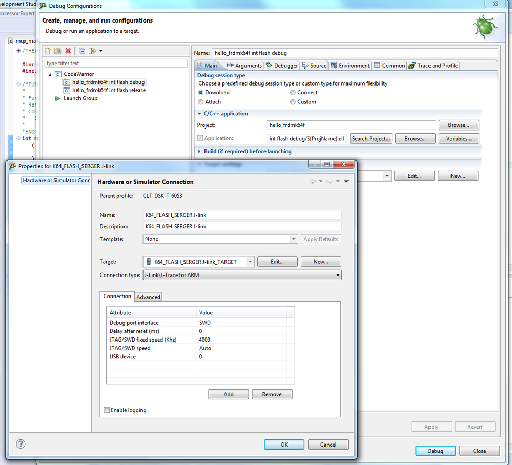

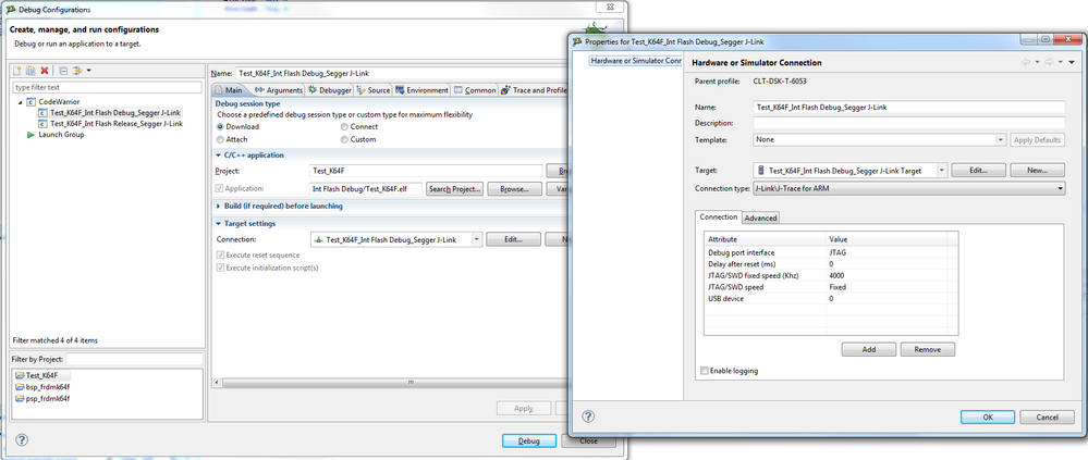

Well, here we go: In the "Hello" example project "SWD" is selected as "Debug port interface" shown in Figure1 below. This is different to my self created project, in which JTAG is selected by default (Figure2). This has to be changed to "SWD" and than my problem is solved!
Hmm, the other question here is now: why is "JTAG" selected even if one chooses "Segger J-Link / J-Trace / SWO (SWD Based)" when setting up a new Project (in section "Connections")? This might be a bug?
best regards Nik and thank you very much for your help :-)
Figure1: "Hello" Example Project: Debugger Target Settings => Debug port interface = SWD
Figure2: My own Project: Debugger Target Settings => Debug port interface = JTAG

Hello Niklas,
I think this is not a bug , for the default configuration of the CW is JTAG  ,
we need refer to our requirement to configure it .
Hope it helps
