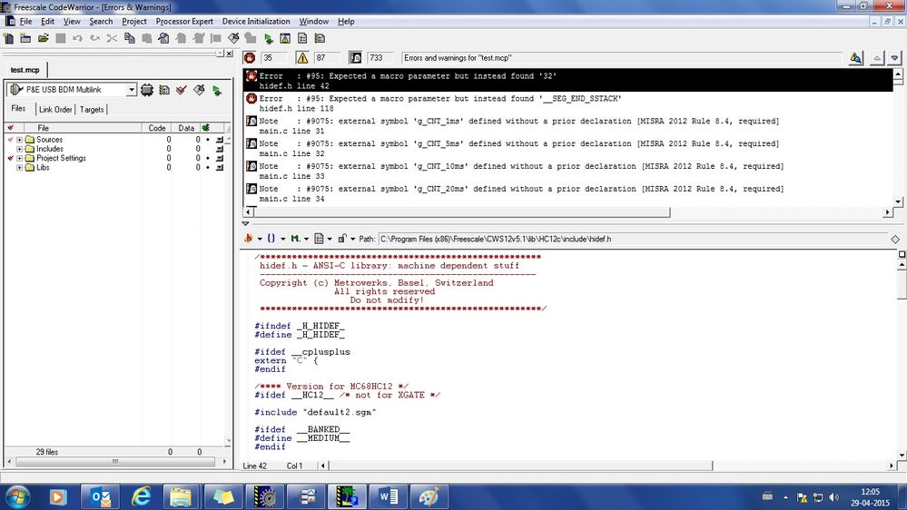

I have integrated the plugin for pc-lint in codewarrior 5.9.0 and am able to see the lint warnings displayed in the code warrior window. But I need to generate log files separately for each c-file so that it'll be easy to work with. Is there such an option ? if not,  if the displayed warnings are stored to a separate file, then I can use a script to create separate log files from them.

you mentioned "lint warnings displayed in the code warrior window", can you please upload a screenshot to show what kind of message you referred to? thanks!

     Please see the image below. When using the pc-lint plugin in the code-warrior, I get the violations in the error window. But this is not ordered and is difficult to process. Hence the need for an option get these errors copied to separate log files based on file names.

Unfortunately, the detailed error and warning message is not included in err.log file.
At present, I advise doing Ctrl+C when the "Errors & Warning" message window is ACTIVE.
Then just do Ctrl+P in a separate file to paste all the errors and warnings.

     Thanks for the info. I too found out only this option, to create a log file and then using scripts , separated the warnings. As this involves manual work, I wondered if we could enable this in code warrior itself.
