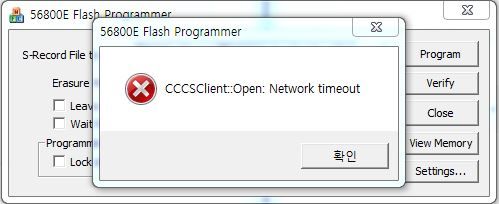

eunaehcho
Thank you for your kindness.
I tried several times, but the problem has still remained.
Running the 56800E Flash Programmer after the CCS, the CCS operation stops.
In addition, the 'Flash timeout 'error occurs in the Flash programmer as below.
I have been struggling for several days because this problem has not been resolved...
5,550 Views
trytohelp
The Flash Programmer V1.2 was released for Win XP 32 bit OS.
We don't have new version supporting Win 7.
The problem is the CCS feature.
The CCS version used is not compatible with 64 bit OS.
We've the same problem with CW for DSC V8.3 for instance.
The workaround is to update the CCS to a new version supporting the Win 7 and 64 bit OS.
You can install the last version included on Eclipse: CW for MCU V10.6.4.
Copy the CCS folder to your installation.
Another solution is to use the DSC Flasher.
You will find details at the AN:
    http://cache.nxp.com/files/microcontrollers/doc/app_note/AN4824.pdf
DSC Flasher can be downloaded from the link:
    56F801X |Digital Signal Controller|NXP
Pascal
NXP Technical Support
