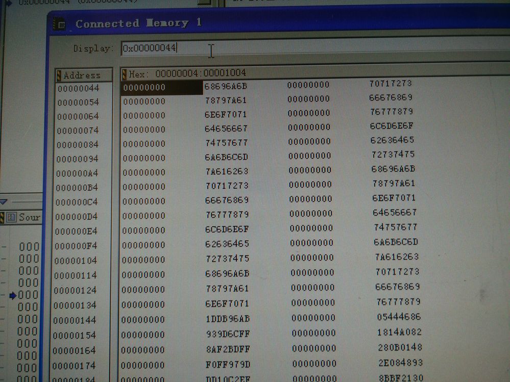

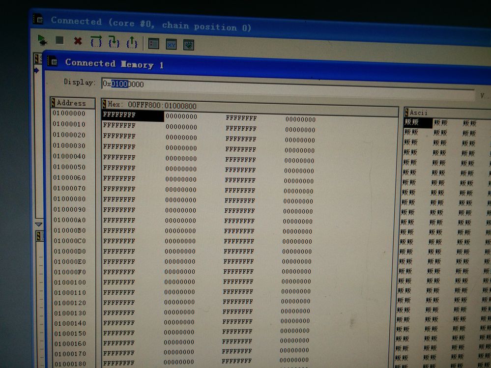

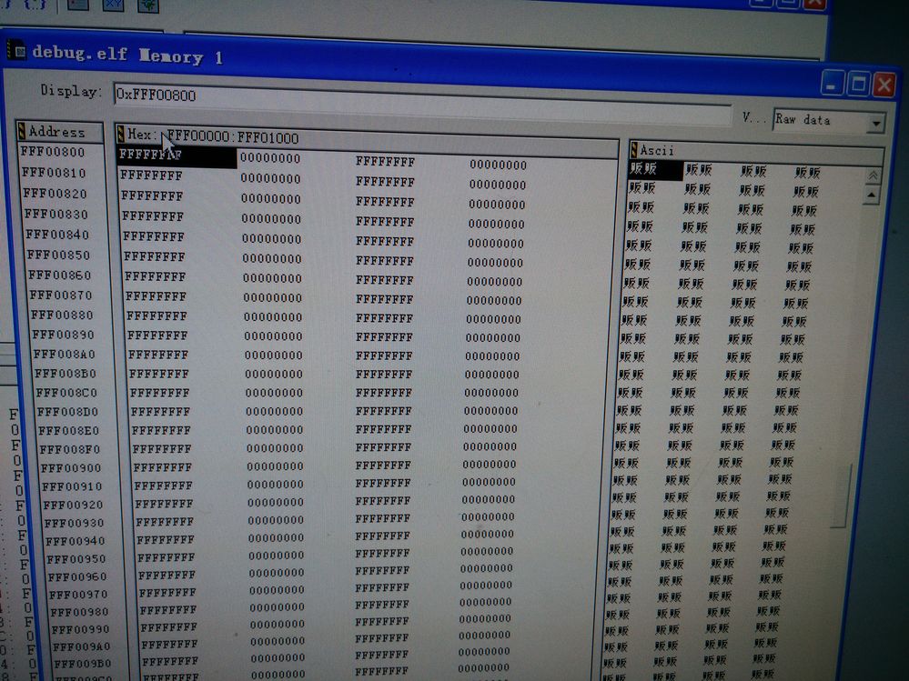

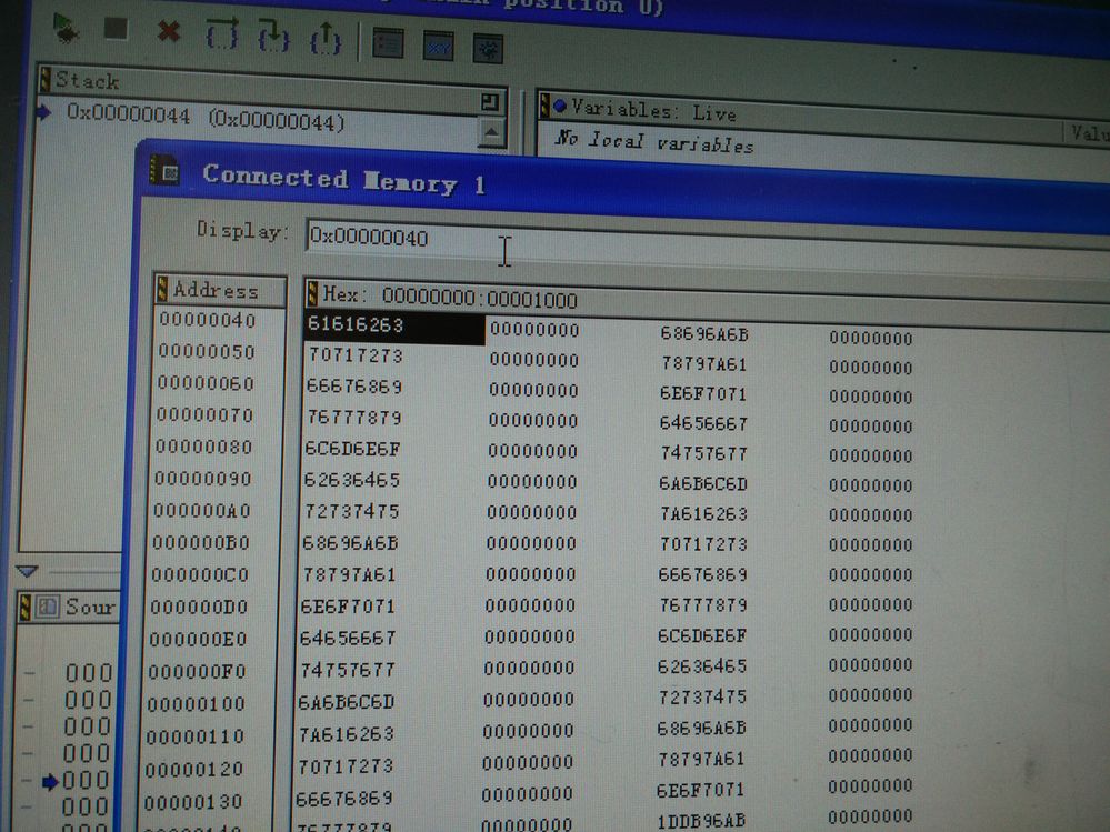

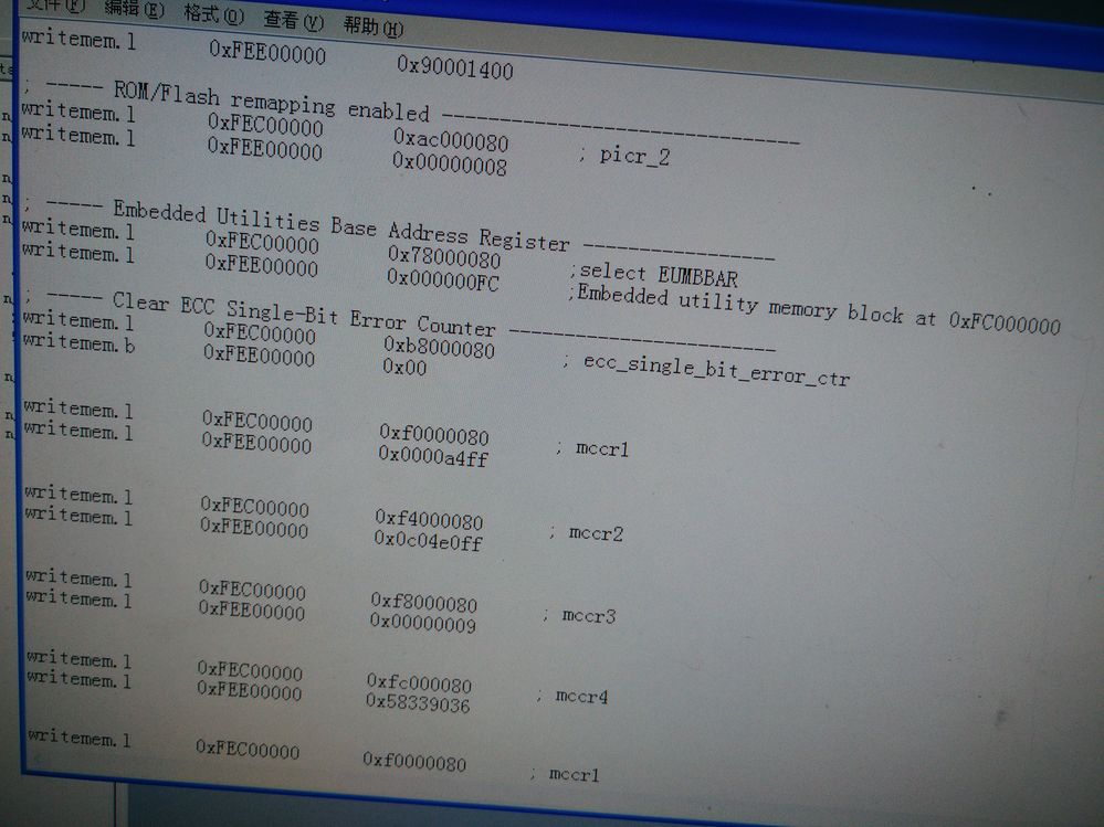

I made a simple board based upon MPC8245. Flash is 8-bit, SDRAM is 32 bit connected to MDH[0:31](composed by 2 IS42S16800F).  For debugging purpose we use CodeWarrior Power Architecture 8.8  + CodeWarrior USB TAP (16 pin JTAG interface). When I try to  write to SDRAM, the address end by 0x4 and by 0xc is 0x0000_0000,address end by 0x0 and by 0x8 is the data I wrrote.like this: 0x0000_0100 : 0x1234_5678 ,0x0000_0000,0x1234_5678,0x0000_0000.I try to write in any different sequence,the result is same.Then I read the space of the ROM,the same result.  So I conjecture this problem is caused by the emulator . few days ago some one tell me that the USB TAP support only 64bit configration of MPC8245, I must  verify this is correct or not,and then I have to make a decision to buy another emulator that can support the 32-bit data bus of MPC8245. 120422_120422.jpgIMG_20151217_095553.jpg120424_120424.jpgIMG_20151221_172323.jpg120425_120425.jpgIMG_20151221_180308.jpg120423_120423.jpgIMG_20151217_095603.jpg

Today I test it again,I find that if I write to the address ended by 0x04,0x0c...,the data bus will be '0' allways.that is say the MPC8245 has written data to the SDRAM,the data just is"0000_0000",so what is wrong?

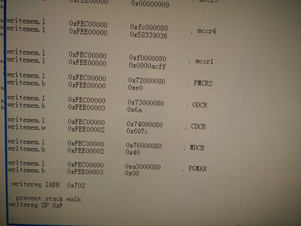

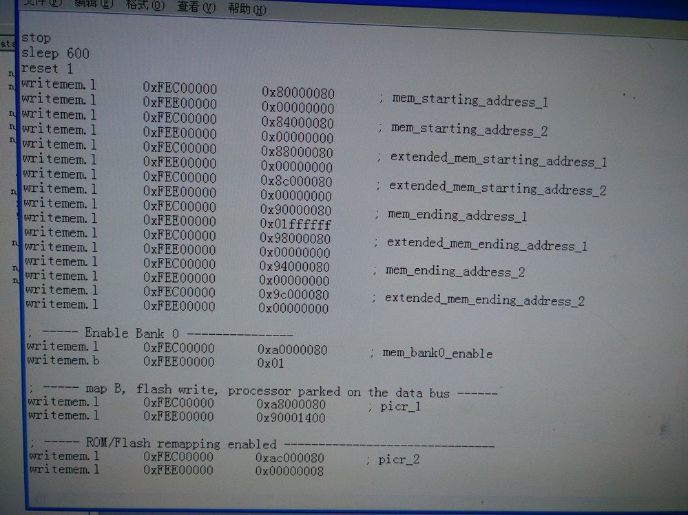

lunminliang
Hello xuchao li,
Can you please share your initialization file?  (*.cfg)
Lunmin

xuchaoli
My initialization file :

lunminliang
Hello xuchao li,
Please see my response there:
ow to configration the MPC8245 when it works in 32-bit data bus mode
Lunmin

xuchaoli
Now,Ican connect my board to CW by USB TAP,the only issure is when I write to the address ended by 0x4,0xc,like 0x0000_0004,0x0000_000c,and so on,the data bus will be all '0'.
My CCS is 4.13

xuchaoli
Hello lunminliang,thank you so much!
Could you give me other way to communicat you,like as emill ,because I can only use My mobile phone,I will send the picture of the configration file to you
