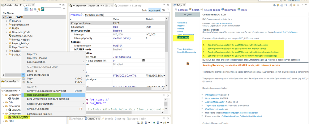

I am new to the NXP microcontroller. I have two S9KEAZN8AMFK 8-bit MCUs and I need to create I2C communication between them(one as master and another as a slave). But I could not find a sample code in the CodeWarrior Development Studio for me to study. Does anyone know where can I get the sample code? Thanks.
2 返答(返信)
1,382件の閲覧回数
Hello Zhouming Wu,
You can  create a project based on Processor Expert, then add
there is sample code under "Typical Usage":
