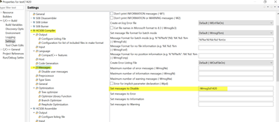

Hi, I'm using CW 11.1 because my processor is MC9S08DZ60A. I am porting some code from another compiler. I would like to suppress compiler warning C1420, return value ignored, because it flags every printf. I found a screen that looks likely, but I put C1420 in there, and also tried just 1420, and the warnings still come up. See attached screenshot.
Is there a way to stop a specific warning message number, or a list of them?

Hi @lslonim
Please add  -WmsgSd1420 to compiler setting to disable C1420

lslonim
Thank you so much! That worked! Then I added more on the same line like this:
-WmsgSd1420 -WmsgSd2705
I appreciate the help!
