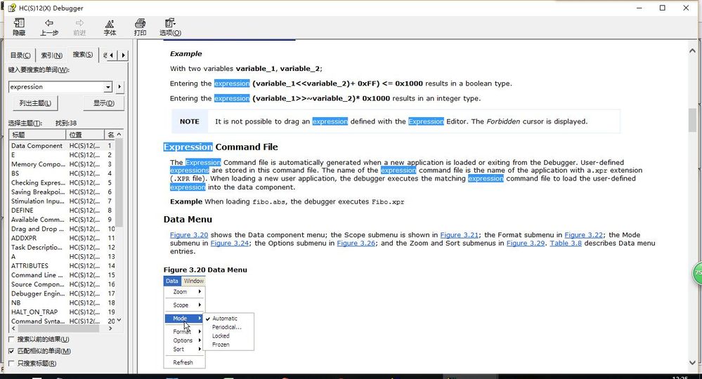

I have solved the problem just now,See the picture below,its described the expression saved in the project.xpr file,
and the project.xpr in the bin file,so open the project.xpr file and modify it,save,and then the expression display in the window of data will display as the content of project.xpr.
@ZhangJennie,不知道你看懂上面的英语描述了没有,反正就是修改一下工程文件bin文件下的project.xpr内容,就可以在hiwave.exe的data1/2窗口里,按project.xpr内容显示了;
个人觉得hiwave应该有bug,project.xpr有时是能够在点击保存时保存,但是多数情况下是保存不了的,不知道为什么。

Hi xiaochen,
thanks for your feedback. I think I understand your input.
the key problem is, as you described, SOMETIMES expression can be stored in xpr file, while SOMETIMES not.
it's necessary to know in what kind of condition then expression can not be stored in xpr.
unfortunately, I tested several times I couldn't reproduce the problem. Question is: How to reproduce the issue?
in stead of modifying .xpr file as you did, can you try to remove the old .xpr file, then perform save setting in debugger again? thus it can generate a new .xpr file. see how this one works?
