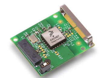

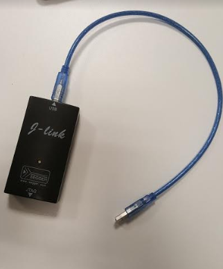

I bought an FXTH87xx for the Tyre Pressure Monitoring System (TPMS), but I need a "USB Multi-link Universal" to the program it but I have a "J-link" owner. What can I do to program fxth87xx without using "USB Multi-link Universal " connections? Please help immediately !!!
Thank you very much in advance...

A1 - We have developed the demo “LF RF Bootloader”, that can be downloaded from this webpage, which implements wireless reprogramming of the FXTH (using LF and RF). However, this requires a portion of the FXTH memory to be previously programmed with the bootloader code. And this bootloader code can only be opened in CodeWarrior and programmed with the PEmicro’s USB Multilink.
A2 - Unfortunately the FXTH cannot be programmed with IAR Embedded Workbench nor KEIL uVision.
A3 - Our recommendation is to use the PEmicro’s USB Multilink Universal.
Tomas

Only CodeWarrior IDE compiler supports the FXTH, and only the PEmicro’s USB Multilink supports the programming of the FXTH. The FXTH cannot use J-Link.
From this webpage, the “Starter Package for FXTH and MKW01” can be downloaded. Inside the package are several folders containing demo code and documentation. Among them, the document “Installing and using CodeWarrior” gives information on how to download a free version of CodeWarrior IDE, and links to buy the PEmicro’s USB Multilink.
Tomas
