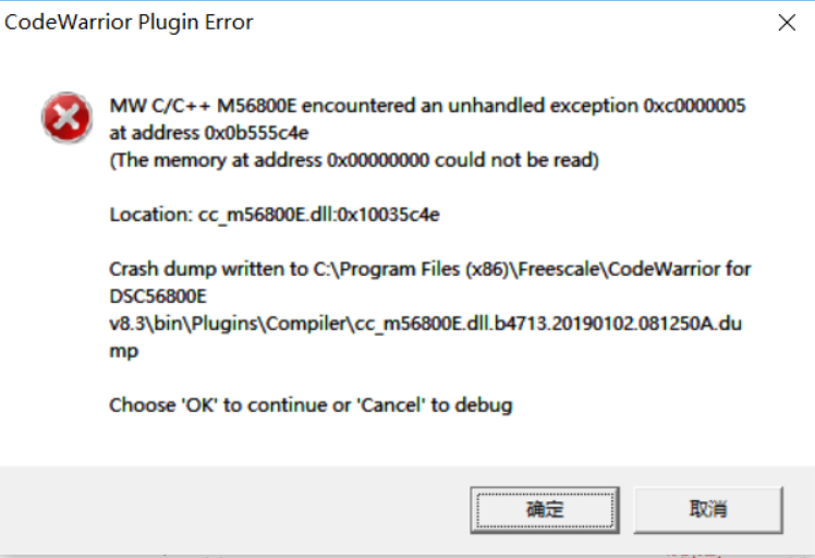

       in the project, I want to read the values of registers FM_OPT1,I write this way:
OCCS_OCTRL.Bits.TRIM    = FM_OPT1;
But there was a compile error(CodeWarrior 8.3):
Why is there such a problem?
Is it a program file error?
Thank you very much!!

Hi  里 王,
We ever have customer met similar problem as yours on win7. He fixed his problem in this way.
-       Right click IDE.exe in the \bin folder.
-       Select    “Properties”
-       Select    “Compatibility”
-       Select    “Change settings for all users”
-       Select    “Run this program in compatibility mode for”
-       Select    “Windows Vista” from pull down menu
-       Select    “Disable visual themes” & “Disable desktop composition” &” Disable display scaling on high DPI settings”.
-       Do NOT select  “Run in 256 colors” & “Run in 640x480 screen resolution”.
-       Hit OK.
Pleases try if this also work for you.
