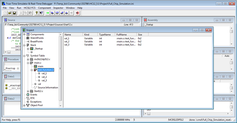

I've tried with CW for HC12 v5.1 which is probably the version you're using.
The local variables are using stack.
I've tried to find a way to extract the information your request via map file and decoder tool without success.
The information is delivered for the global variables only.
Now the information is provided in the Inspector component.
You must launch the debugger to have access to this feature.
Under Component + Open ...  select Inspect.
A new component will appear: Inspect.
Under Symbol Table you could check for each module, function the variables associated and other information.
This is the right way to check it.

Hi Pascal,
                Thanks for the information. I have verified according to your suggestion.
                I am able to get the information as follow:
  • Ø Inspect
  • Symbol Table
  • .c file Name
  • Function Names
    • Local Variables
    • Static Variables
  • Global Variables
But I want see ONLY local variables with respect to each functions. I have many .c files and functions in our project.
And how I can extract these information into a file, so that it is easy to  filter, verify, analyze etc.

trytohelp
Hareesha,
The linker can generate a statistic file but it includes global variables only:
main.c.o    main    2129920    15    2    .text
main.c.o    test_function_1    2129935    38    2    .text
main.c.o    val    2304    2    4    .data
Start12.c.o    Init    2129973    41    2    .text
Start12.c.o    _Startup    49152    11    0    .init
The Burner can not generate this type of doc too.
Unfortunately with the Inspect component can not export something.
For me there is not way to create the document you're looking for.
