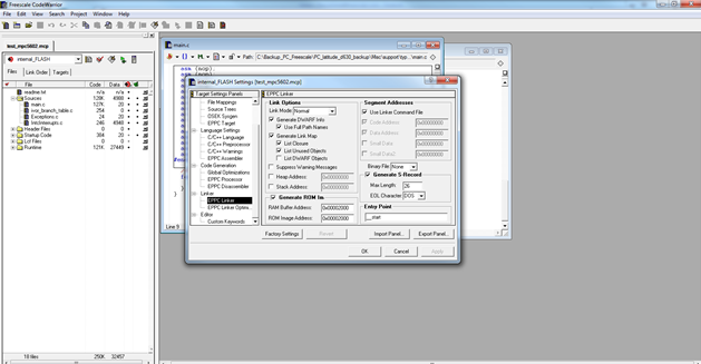

codewarrior 2.10  Can produce elf file, but I need a S19 file.What should I do? Used for MPC5643L boot flash program;

In addition to Erich feedback, the Srecord file generation can be selected at linker option too.
the file will have .mot extension.

BlackNight
I'm using the 'srecord' tool for all kind of conversions and manipulations, and one of the simpler things it does is to generate an S19 file from a .elf file. See CRC Checksum Generation with ‘SRecord’ Tools for GNU and Eclipse | MCU on Eclipse
I hope this helps,
Erich
