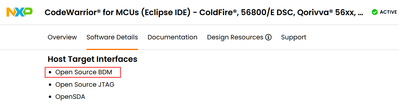

Sorry for the later reply.
CodeWarrior for MCUs (Eclipse IDE) supports OSBDM debugger tool.
There are two documents about OSBDM, please refer below links for details:
AN4331: Enabling OSBDM DLLs
OSBDM-JM60 user guide
You also could find OSBDM basic info from P&E website:
https://www.pemicro.com/osbdm/osbdm_description.cfm
While, P&E has discontinued support for OSBDM.
We recommend to use P&E Multilink debug probes.
Thanks for the attention.
