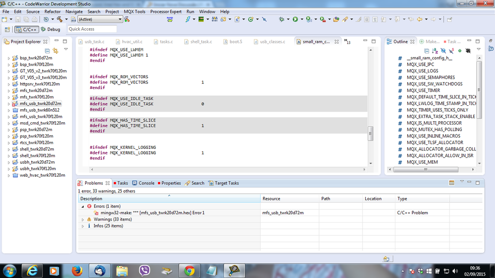

I need to generate a .srec from a MQX 4.2 project, but I can't. I went to Project Properties and tried to enable this, as you can see in the following images bellow. I don't know if I missed something. Can anybody help me, please?

Hi Marco,
the Console view (with the build messages/command line output) should show you more what the problem is. Can you share this?

Here it is:
**** Build of configuration int flash debug for project mfs_usb_twrk20d72m ****
"C:\\Freescale\\CW MCU v10.6.4\\gnu\\bin\\mingw32-make" -j8 pre-build main-build
C:/Freescale/Freescale_MQX_4_2/mfs/examples/mfs_usb/build/cw10gcc/mfs_usb_twrk20d72m/makedir.bat "C:/Freescale/Freescale_MQX_4_2/mfs/examples/mfs_usb/build/cw10gcc/mfs_usb_twrk20d72m/int flash debug"
'Executing target #8 mfs_usb_twrk20d72m.hex'
'Invoking: ARM Ltd Windows GNU Create Flash Image'
"C:/Freescale/CW MCU v10.6.4/Cross_Tools/arm-none-eabi-gcc-4_7_3/bin/arm-none-eabi-objcopy"  -O srec mfs_usb_twrk20d72m.elf "mfs_usb_twrk20d72m.hex"
makefile:112: warning: overriding recipe for target `mfs_usb_twrk20d72m.elf'
makefile:71: warning: ignoring old recipe for target `mfs_usb_twrk20d72m.elf'
C:/Freescale/CW MCU v10.6.4/Cross_Tools/arm-none-eabi-gcc-4_7_3/bin/arm-none-eabi-objcopy: 'mfs_usb_twrk20d72m.elf': No such file
mingw32-make: *** [mfs_usb_twrk20d72m.hex] Error 1
Every time I enable Flash Image generation in Project Properties, this error comes up and the *.elf file that was in "Int Flash Debug" folder simply disappears. The same happens for other MQX 4.2 demos.
