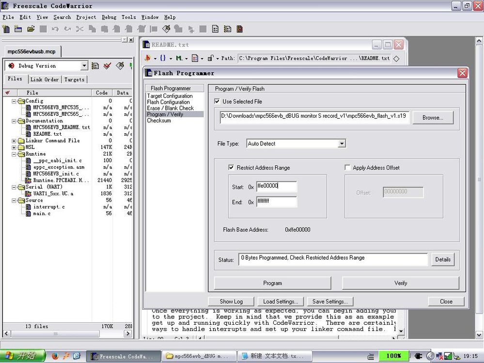

Hello
I am using MPC566EVB for the project, but I can't get the dBug monitor message on the terminal when power on the board. I have downloaded codewarrior PowerPC 5xx V8.7 and want to use it to restore the dbug ROM software for the board,however i can debug and run the "Welcom to Codewarrior" demo, but i havn't the dBug software for the board,Would you help provide the dbug software and tell me how to restore it with codewarrior? thanks!

stanish
I've found the dBug monitor image here:
http://www.axman.com/sites/default/files/mpc566evb_dBUG%20monitor%20S%20record_v1.zip
As far as I know CodeWarrior for MPC5xx v8.7 includes flash programmer which you can use to program dBug ROMmonitor srecord.
Unfortunately I don't have a board to test.
Hope it helps.
Stan

leizhihualqytvw
Hi Stan,
I download the dBug ROMmonitor srecord file from AXMAN website,and to programm the image with Codewarrior MPC5xx v8.7 Flash Programmer,but the programmer can't burn the srecord and show--" 0 Bytes Programmed, Check Restricted Address Range" and more details infor as below and attach picture,however i can erase the all external flash and burn the "Welcom to CodeWarrior!" demo image(rom.elf),but I can't successfully burn this dBug ROMmonitor srecodd image file,Would you help give us some suggestion to close the issue?thanks for your support!

=== Execute: Program
=== Timestamp:  Thu Mar  2 19:15:02 2017
=== Flash Device:         AM29BDD160GT
=== Flash Organization:   512Kx32x1
=== Flash Mem Start Addr: 0xFFE00000
=== Flash Mem End Addr:   0xFFFFFFFF
Using restricted address range 0xFFE00000 to 0xFFFFFFFF
Using Algorithm: amd32x1.elf
Informing other connection clients that the target is being 'clobbered'.
Loading Flash Device Driver at: 0x00C02000
Flash Driver Buffer is at:      0x00C03DB0
Flash Driver Buffer Size is:    0x0005E250
Done
Initialization Command Succeeded
Programming file D:\Downloads\mpc566evb_dBUG monitor S record_v1\mpc566evb_flash_v1.s19
Trying auto-detect...
Auto-detection is successful.
  File is of type Motorola S-Record Format.
Programmed total of 0x00000000 bytes
Timestamp:  Thu Mar  2 19:15:04 2017
: No Error
