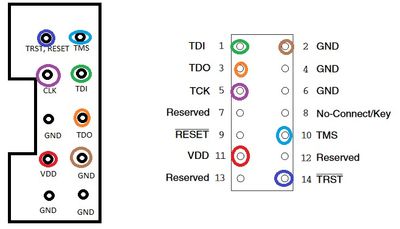

Ok, so I have installed CodeWarrior 8.3 since my target is only supported by this version. I made the connection PC – USB TAP following 3 and 4. The LED TX/RX of my USB tap is blinking in green, so I assume this is good!

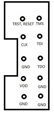

I have identified the pins of my target. I have the DSP56F807 build in a board, but this board has a 10 PIN connector. Those pins go through other components (optocouplers and buffers), but if I track the connections with a multimeter and the datasheets of the other components, I get:
So, I connect this 10 PIN connector to the USB TAP like:
Then, I give power to my board (It needs 25V and 1A). The RUN/PAUSE LED is now red. And when I try to Debug or Debug -> Connect in CodeWarrior 8.3, I get the following error:
CCS Protocol Plugin: Unknown Protocol error
I googled this, and it seems like a physical connection error. But I do not know how to connect everything (I have 10 PINS, and the USB TAP has 14. I can figure out how to connect TRST and RESET since those two go to the same PIN, and the other GND cables, but not the “RESERVED” ones.
Any ideas? Is it a physical connection problem or is it something else? Should I connect directly to the core or can I go through those other components my board has?
Thanks in advance. I hope I have explained myself well enough.

Hi, Julia,
I attach the schematics of DSP56F807 EVM board, pls refer to J3 connector for the JTAG pin assignment.

I am using the CCS from the latest version of CodeWarrior, and I am able to stablish the connection with USB TAP with config cc utap. The TX/RX turns from red to green. When I click on Debug, the CCS API shows that I have accepted and closed the connection. So I guess this part is OK since CodeWarrior 8.3 is connected with my Windows 10.
But I am still having the same error. As lng as I undertand from the evaluation board of the DSP I am using, the PINS 7, 12 and 13 can be unconnected (showing NC from https://www.nxp.com/docs/en/user-guide/DSP56F807EVMUM.pdf). As I said, my core RESET and TRST pins are "wired together" in my board, and they go to the same JTAG PIN.
Is it OK if I connect both USB TAP RESET and TRST to the same JTAG pin? And is it ok if the signals go throught other components before connectiong to the core? Or should them go directly yo it?
Thanks for your reply!

Hi, Julia,
Now that the 14 pins JTAG connector has TRST signal, I think you'd better connect the TRST pin of DSP56F807 to the pin 14  of 14 pin JTAG connector.
But I think it is okay to connect the TRST to Reset directly.
 you'd better connect the TRST pin of DSP56F807 to Low via a pull-down resistor when the DSP56F807 runs standalone.
