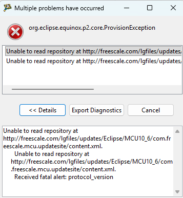

I have installed CodeWarrior Development Studio, CodeWarrior for MCU v10.6, and I'm trying to work with a HCS08 (S08/RS08) microcontroller.
During the installation, I was unable to access the Freescale website to download the software package for this microcontroller.
After the installation, when I try to install additional software, the problem persists.
Please, could anybody send me the installation package for this microcontroller or help me resolve the issue?

Hi.
I found the soltion to my problem. I´ll post it here for anybody's help.
You just have to open the available the software sites and change the 'freescale.com' site with 'cache.nxp.com'.
In my case: FSL MCU Eclipse Update Site - http://cache.nxp.com/lgfiles/updates/Eclipse/MCU10_6/com.freescale.mcu.updatesite
Hope it helps! For me, one day lost...
