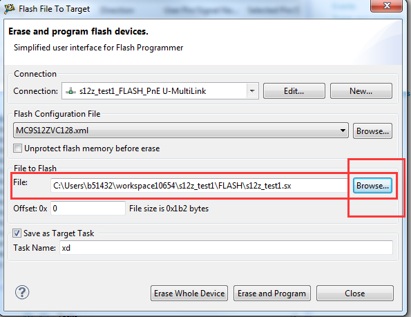

As you may know, we can download S19 file to target board if we use classic CodeWarrior 6.3 and USB multilink.
But CodeWarrior 6.3 does not running on Windows 7 64-bit.
Therefore, I had installed CodeWarrior 10.7 now, but I cannot find out how to download S19 file to target board using CodeWarrior 10.7 and USB multilink.
Please let us know how to download S19 file to target board using CodeWarrior 10.7 and USB multilink.
Takashima
1,702 Views

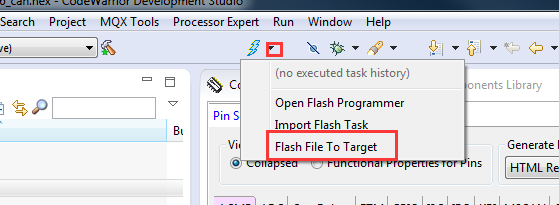

Hello lsao,
On CW10.7 we also can flash the s19 file , please click the "Flash File To Target",
then in the configure view , select your s19 file :

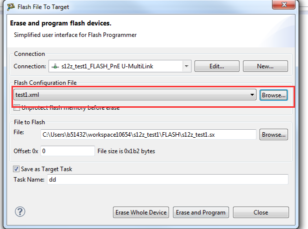

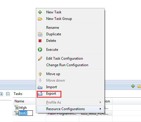

Hello Lsao,
Maybe the below method can help you , you can test it as the steps :
- After you configure the Task, save it : right click your Task, select Expert ,  input a name , for example " test1 ".
- Click the "Flash File To Target" as i said before , in the "Flash Configure File" select the "test1.xml":
- Then refer to these steps to do :
Hope it helps

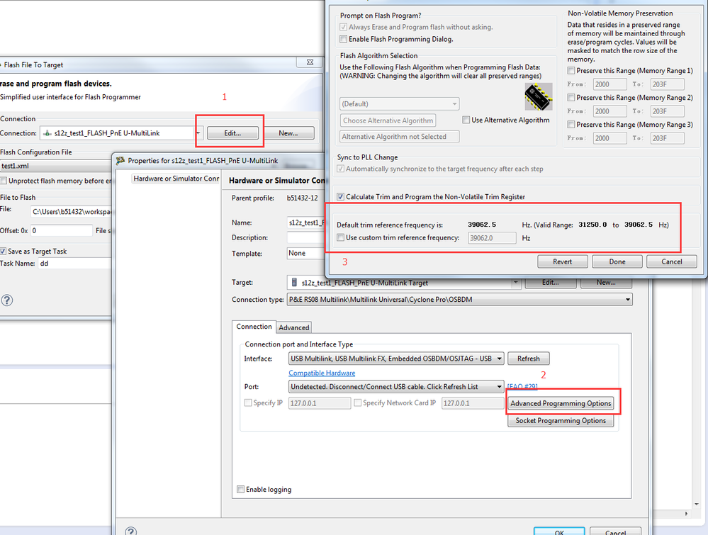

isaotakashima
Dear Alice Yang,
Thank you for your reply.
I also setup Advanced Programming Options and check Use custom trim frequency as below.
But Flash File To Target project does not program trim value.
Can your Flash File To Target project program trim value to target MCU?
Takashima
