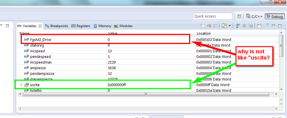

The CW10.6 in debug session do not show the structure of the variable:
the variable is declared in main.c like:
"MCSTRUC_FOC_PMSM_T gsM2_Drive;"
the structure "MCSTRUC_FOC_PMSM_T" is composed like:

The compiler work right = no errors.
The program work on my board.
BUT the degub program do not show the variale of the structured "gsM2_Drive" like i showed in the following picture:
The same problem happen with this project in Freemaster.
Freemaster do not show me the structure of "gsM2_Drive" !
Somebody can help me ?

Hi Antonio,
do you have any compiler warnings?
Are you including the header file with the declaration of MCSTRUC_FOC_PMSM_T before you are using that variable?
I suspect that something might be wrong with your includes?
Erich

antonio66
Hi Eric,
You are very reactive ! thankyuo a lot.
Yes before the declaration is included
#include "motor_structure.h"
where the type of structure is declared.
If is an include problem why the compiler work right ?
why the execution of the firmware is right and the other variable in freemaster work well ?

BlackNight
Hi Antonio,
I suggest that you fix all the warnings anyway.
That you can compile your sources does not mean that the debug information is correct (DWARF). The debugger and Freemaster rely on the debug information to show the variables with types. Are the other variables from that module shown properly? Not that you just have switched off debug information for it.
Erich

BlackNight
By default, it is turned on. But I have seen cases where users have accidentially disabled it. This is an option in the compiler.
But if you can step through that module which has that variable, and if you have all the other variables of that module/source visible in the debugger, then this is not your problem.
It looks like you are using the DSC compiler, and just a wild guess: it even could be that this compiler might have a problem to produce the correct debug information for your variable. Again, just a wild guess.

antonio66
Hi Erich,
Yes i'm using DSC compiler
you says "..it even could be that this compiler might have a problem to produce the correct debug information for your variable. "
Before my test I tried to open and compile the example project of freescale "56F84789_PFC_2PMSMsensorless_1.0" with the same
strructured variable and the freemaster show the right structure of the variable with all the members of it.
6,139件の閲覧回数
antonio66
I show you some of the others variables of the module..
..and the others variables are visible in debug like you can see here..
.. i also tried to "add global variable" in the debug session and than i tried to "Cast To Type" in debug variable window without success.
