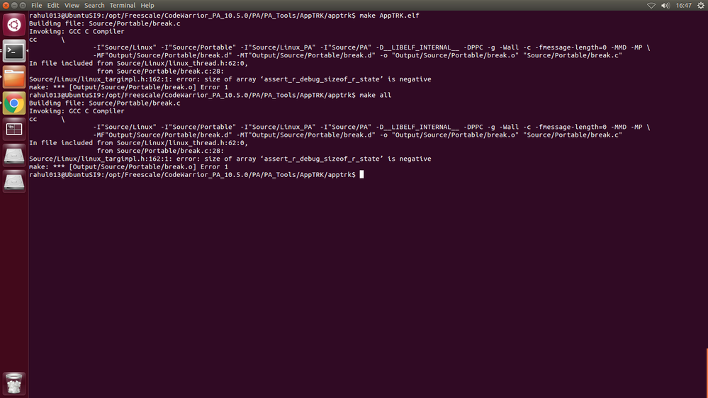

rahul011189
I don't think the error is related to toolchain. Please see the following error log.
I followed the steps in Freescale\CW_PA_v10.5.0\PA\PA_Tools\AppTRK\appTRK\INSTALL.
The configuration step is successful but MAKE is throwing errors.

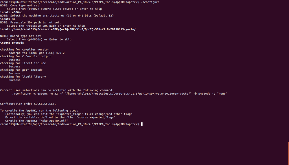

addiyi
Hi Rahul,
Did you use ./configure? Could you share configure command? Did you build libelf before building apptrk?
Adrian
5,530 Views
rahul011189
As I mentioned the configuration step was correct. The ./configure did not throw any errors. And yes libelf was built.
5,530 Views
rahul011189
Adrian,
Please see the snapshot for ./configure step.

rahul011189
Hi Adrian,
I tried the same steps as you mentioned over and over again but I kept getting errors in the source files.
But after removing the apptrk folder and regenerating it from the back up .tar file, I was able to generate the AppTRK.elf file with the same sequence I was trying earlier. Not sure what the problem really was.
Anyways, the problem is solved. Thank you very very much for your support.
