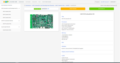

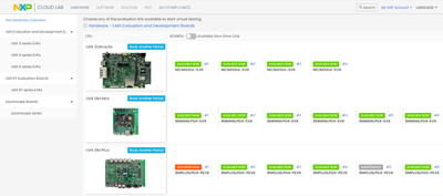

3. Book your favorite EVKs
How to book your favorite EVKs
  • You can book the HARDWARE
    Take “hardware” for example, all hot hardware will be shown by clicking “HARDWARE”, You can also click on the filter button-“view all boards”, to see all the EVKs in the Cloud Lab.

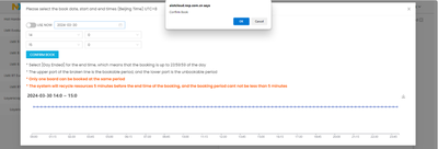

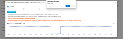

  • Select one EVK and click “BOOK NOW”. Here, you can use it now by clicking on “USE NOW” or book the time to make an appointment.

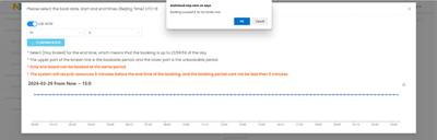

    • USE NOW: means you can immediately use this EVK, just need to select an end time and click “CONFIRM BOOK”
    • Reserve an EVK: select the date and time  and click “CONFIRM BOOK”

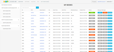

  • After booked,  pop-up windows will take you to “my book” page. Please note that user can only book one EVKs  in the same period.
How can I check my reservation
  • You can manage your booking in “MY BOOK” page.  Let’s click the “debug” button and experience the cloud lab.

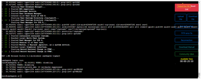

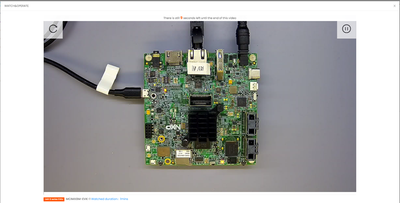

How can I watch the video  during debugging?
  • You can watch the video of EVK board and see the light status. But please note that , the video will be closed in 30s. Pls click “Adrian_12-1713983940407.png” to play the video again.

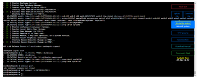

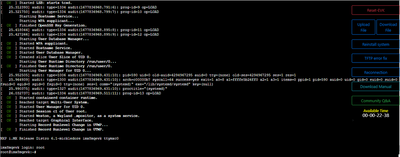

How can I debug my EVK board
  •  The command line will automatically connect the board serial port, when the camera is turned on.
  • All EVK boards are Linux system, pls login with root.

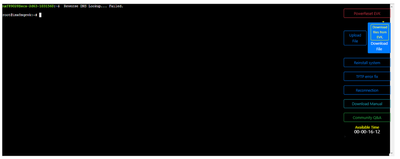

 Can I reset my EVK board when I facing some errors
  • Sure. Please click “Power Reset EVK” to hard reboot the board and wait several second, the board will be rebooted.
Can I reinstall my EVK when I facing some errors?
Sure. You can click the “Reinstall the system” button to recover the default setting. (It will take several minutes to reinstall the system , this action will also delete the files you created or modified. Pls save your copy before you reinstall the system.)

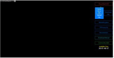

How  can I upload/download files  during debugging
  • Click the “upload files to EVK” to upload the file you need.
  • Please note that If you would like to upload files to board's Network File System(NFS),  you will find your files in board's /home/root path. If you would like to upload your own Image or dtb file,  use "TFTP" tab.
