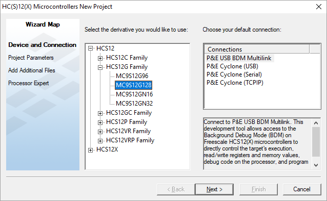

I'm trying to use "CodeWarrior for HCS12(X) Microcontrollers v5.2" to create a project featuring an mc9s12g192 MCU.
However, the New Project wizard doesn't have this MCU listed in the options:new_project_wizard.PNG
I can see the mc9s12g96 and mc9s12g128 options, but no mc9s12g192.
Could you clarify please:
- Is it possible to make a mc9s12g192 project using this IDE?
- If not, which IDE should I use?
Thank You.

Hello @mcu_tester
This Service Pack is designed for CW v5.1. If you want to install it on CW v5.2, please refer to:
Thank you.

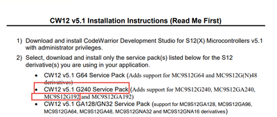

Unfortunately I'm having a problem finding the "CW12 v5.1 G240 Service Pack" - it's not clear where to get it.
Could you please provide the download link?

Hello @mcu_tester
Please download and install the G240 Service Pack, which supports MC9S12G192.
CW12 v5.1 S12G Read Me First
