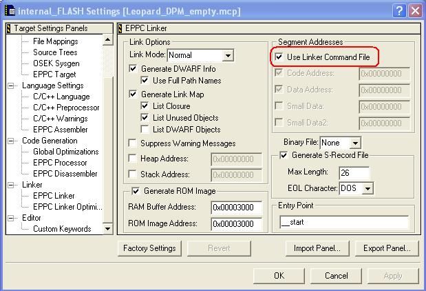

in order to use your own .lcf file in CodeWarrior IDE:
1) make sure the project is configured to use linker command file: ALT+F7 -> "EPPC Linker" -> "Use Linker Command File" (see the CW_Linker_settings_lcf.jpg)

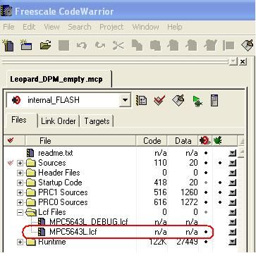

2) add your .lcf file into a project and assign the .lcf file to appropriate target (see the black point in the target icon column at .lcf file row - CW_Project_lcf.jpg). There can be only one .lcf file associated with a target otherwise warning message appears.

kleckerspur
Hello  Stanislav Sliva ,
coud you please tell me where are the following files?
Thanks kleckerspur
1,809 Views
stanish
I reattached the files below:
Hope it helps.
Stan
