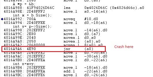

I'm maintaining an old product based on MCF5208, I found some code behavior is strange, so I wrote a simple test code to do test. I think I found a compiler bug when using C++ virtual  function.
class A
public:
virtual int Size()=0;
class B:public A
public:
virtual int Size()
return 10;
static B b;
void test(void)
A *p = &b;
int x = b.Size();
int y= p->Size();
int z=x+y;
When code run to p->Size(); it will crash.
I have decompiled the code and run it in step mode, I found it crashed in the line I marked red.
Is this a real problem or it just because of some incorrect compiler settings?

henryhei
I have tried to use this new version, but as you know, the new eclipse based codewarrior can not translate the project file automatically, I spent more than three days to do this manually but failed.
For our legacy project, changing the compiler is impossible, the only thing I want to know is that whether it is a known issue.
And can you give me the bug list of Version 6.4, then we can avoid this type of problems. Because our product is a Safety product and has a SIL1 certification, our management are very worried about this problem.
