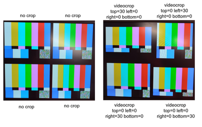

Dear NXP team,
I tried the pipeline [1], but I encountered an error [2]. Then, I tested the mosaic pipeline [3] (since we will be using a mosaic setup) and got the result [4]. Cropping from the right and bottom worked as expected, but when cropping from the top, it also cropped the bottom. Similarly, when cropping from the left, it also cropped the right. Is there an option to crop on the left without modifying the right part and to crop on the top without modifying the bottom part?
I'm using imx8mplus with gstreamer 1.22 with Mickledore kernel 6.1.36 yocto image.

[3]
gst-launch-1.0 \
videotestsrc ! videocrop top=30 left=0 right=0 bottom=0 ! videomixer.sink_0 \
videotestsrc ! videocrop top=0 left=30 right=0 bottom=0 ! videomixer.sink_1 \
videotestsrc ! videocrop top=0 left=0 right=30 bottom=0 ! videomixer.sink_3 \
videotestsrc ! videocrop top=0 left=0 right=0 bottom=30 ! videomixer.sink_4 \
imxcompositor_g2d name=videomixer \
sink_0::xpos=0 sink_0::ypos=0 sink_0::width=600 sink_0::height=480 sink_0::keep-ratio=true \
sink_1::xpos=640 sink_1::ypos=0 sink_1::width=600 sink_1::height=480 sink_1::keep-ratio=true \
sink_3::xpos=0 sink_3::ypos=560 sink_3::width=600 sink_3::height=480 sink_3::keep-ratio=true \
sink_4::xpos=640 sink_4::ypos=560 sink_4::width=600 sink_4::height=480 sink_4::keep-ratio=true \
! waylandsink sync=false enable-last-sample=false qos=false

To effectively use the videocrop Gstreamer plugin on the iMX8 you can refer to the iMX Linux User Guide section 7.3.17 Video Conversion.
i.MX Linux User's Guide (nxp.com)
It seems you are missing the plugin imxvideoconvert_g2d videocrop-meta-enable=true.
