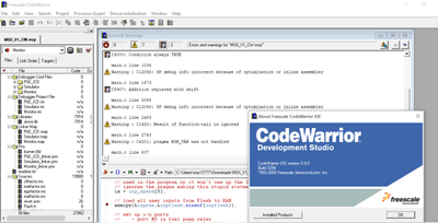

CW IDE V5.9.0 Build 5294. I have a project using an MC9S12C64 with existing code that I would like to modify, but I am having no success getting it to compile. When I try Make, I get this error message:
ERROR: C4422: ' Missing
flash.asm line 51
and the warning message:
Warning: C4450: Multi character constant
flash.asm line 51
The error points to line 51 in the flash.asm file, but it is a line of information commented out with ;* at the beginning of the line.
Can anyone help me with this?
Also, does CW generate an object file and if so where can I find it?
Robert

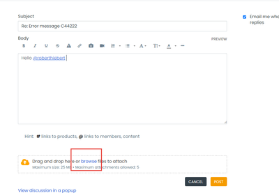

Hello @roberthiebert
Please attach it through "browse" button as below:
Alice
I open your project and compile it on my side, it seems there is no error. Just some Warnings.
Alice

Thanks Alice. I apologize for my late reply but I was away from my computer for a couple of weeks.
There are a lot of unused files in the zip file I sent you, and I need to use the BDM. I tried to create a new project with just the files that I need to keep things a simple as possible. When I did this and tried to compile, it came up with several errors that I don't know how to deal with. I'm attaching the zip file.
Robert
