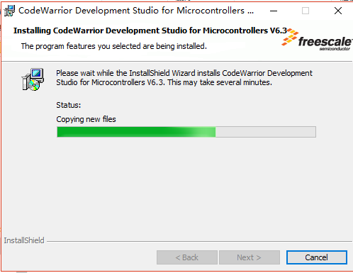

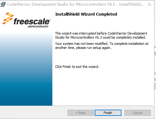

          The problem is after clicking "setup", it cannot be installed successfully, after "copying files" as picture 1, it skips to picture 2, said it was interrupted.
         Thanks in advance.

Yes. I have also seen same as Yuxi has reported.  Starts the installation by coping the files by opening a window and abruptly stops and prompts that installation completed and exit.

There is no problem for me to find msi file inside CW6.3 install package. see my video here
Codewarrior Ver6.3 installation in Windows 10, 64 bit system
BUT please note, "How-to Directly Install CodeWarrior 6.3 Classic in Windows 7 & 10 x64 (Unofficial Method) ". is unofficial method, NXP can't provide technical support

Hi Yuxi
CW6.3 was released before win7/10 released time. It can not support 64bit win7/10.
If you use 64bit win7/10 and HCS08 device, I suggest you use CW10 instead
CodeWarrior for Microcontrollers-Eclipse IDE|NXP
There is a workaround provided by our customer. But officially NXP can not provide support for this workaround:
https://community.nxp.com/message/310577
