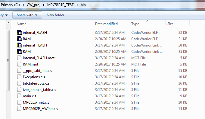

FYI: Another option is:
1) enable object files to be created by pragma store_object_files
https://community.nxp.com/message/98264?commentID=98264#comment-98264

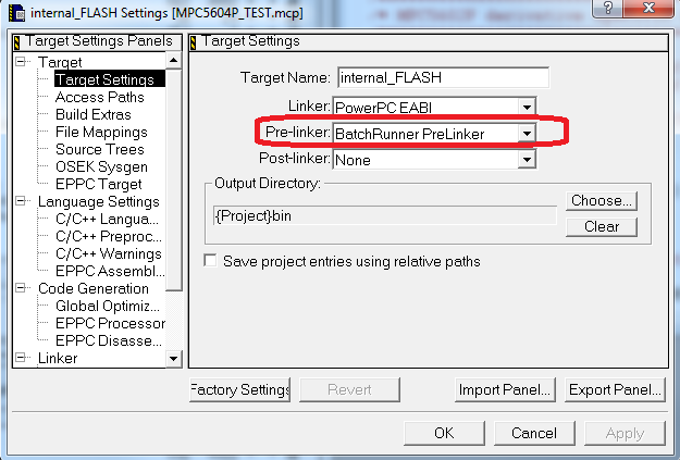

2) enable Pre-linker batch runner:
3)create a batch file in your project folder that disassembles all object files generated e.g.
disassemble.bat:
"c:\Freescale\CW for MPC55xx and MPC56xx 2.10\PowerPC_EABI_Tools\Command_Line_Tools
\mwldeppc.exe" -S <Path to your project folder>\<ProjectName>_Data\internal_FLASH\ObjectCode
\*.o -o <Path to your project folder>\bin\
4) setup BatchRunner PreLinker to execute disassemble.bat before linking the project:
Rebuild the project and now the output directory should include the disassembly listings (*.s):

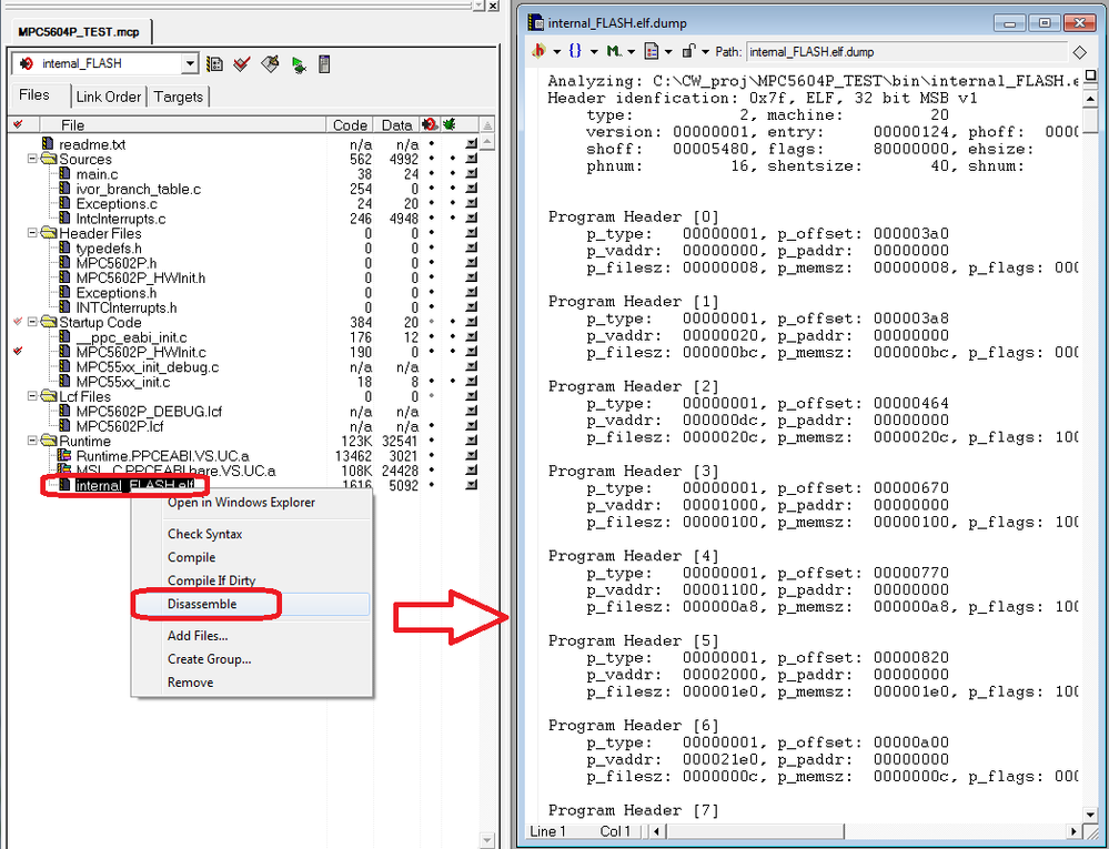

stanish
Yes, you can generate disassembly from .elf file.
all you need to do is to add .elf file into the IDE project and right click on it and select "Disassemble":
Hope it helps.
Stan
