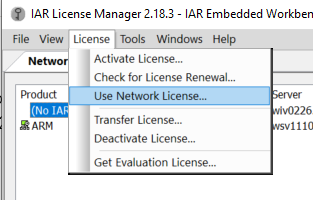

  1. About the IAR IDE
    1. For internal use, you can download it from internal server. http://10.193.108.11/_IDEs/IAR/9.30.1 (user: ubuntu11, pwd: Test@2021)
    2. Click EWARM-9301-50054.exe to install
    3. Update license serve. In help -> License Manager
  1. In add a server -> add, copy wsv11103.swis.cn-sha01.nxp.com into it

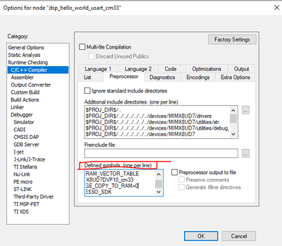

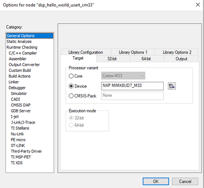

With IAR, something to pay attention to:
  1. Select the device as NXP MIMX8UD7_M33
  1. The DSP_IMAGE_COPY_TO_RAM in Defined symbols.
If set to 1, DSP application will launch from Arm core; if set to 0, it will not launch from Arm core, and can be loaded from Xtensa Xplorer.
You can also find explanation in GETTING STARTED GUIDE FOR I.MX 8ULP.

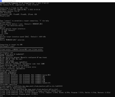

  1. Load the m33 bin file to nor flash
In the above step, there is already m33 bin in nor flash. This step explains how to load m33 bin alone when you only have change in m33.
  1. Switch board to serial download mode
  2. use Jlink commander V7.50 to connect to it.
  3. Then use the command to load bin file: loadbin _flash_dualboot_m33.bin 0x4000000
