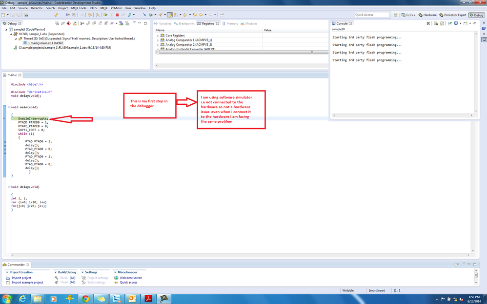

hi i am just toggoling a paticular pin in port a i am not able to get expected result. i have included the code below please take a look
#include <hidef.h>
#include "derivative.h"
void delay(void);
void main(void)
EnableInterrupts;
        PTADD_PTADD0 = 1;
PTDPE_PTDPE0 = 0;
         while (1)
PTAD_PTAD0 = 1;
delay();
PTAD_PTAD0 = 0;
delay();
PTAD_PTAD0 = 1;
delay();
PTAD_PTAD0 = 0;
delay();
                __Reset_Watchdog;
void delay(void)
int i, j;
for (i=0; i<200; i++)
for(j=0; j<200; j++);

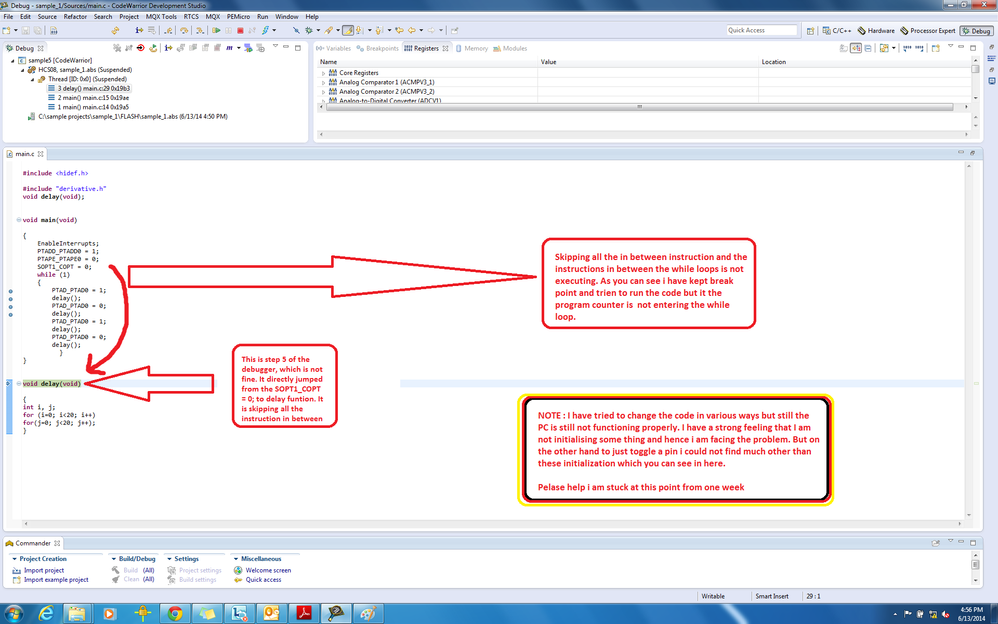

The problem that i am facing is that when i run in debug mode setp by setp execution the program counter in not going according to the written program it is getting currupted and the other thing that i noticed is that when last four lines of the code in while loop, except for" __resetwatch dog" is taken out  then the code and the debugger works ablsolutely fine but as soon as i include another toggle in the code the problem starts.

ZhangJennie
hi vikas,
you mentioned "program it is getting currupted ".  can you please send me a screenshot of it?

ZhangJennie
hello Vikas,
the problem is due to optimization. the simple way to avoid optimization is to add "asm nop;"

vikassubramani
Hi Jennie,
               Thanks a lot for the reply it did work by inserting above line.
