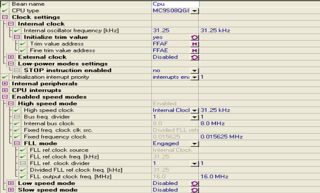

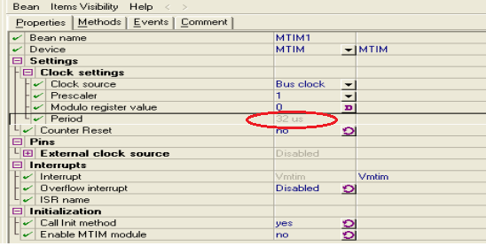

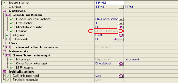

In the microcontroller MC9S08QG8 there are a timer module (MTIM) and a timer / PWM module (TPM). In both modules, you can select the clock source you want to use. I selected the bus clock.
When I opened processor expert to initialize both modules,I configured the clock source of both modules were the bus clock, so both modules should have the same frequency and therefore the same period. Processor expert indicates the period and in both modules is different. TPM period is 256 times greater than the MTIM period. All this happens with the same configuration of the system clock.
My question is: ¿ why does this happen? Someone knows what happen?
  I attached some pictures which shows what I mean.

Hi Maria,
the modulo register of MTIM is 8-bit,  but TPM's is 16-bit.  Modulo register value =  0 is equat to modulo value = 65535.
in your setting, MTIM, 0.125 * 256 = 32us, TPM: 0.125*65536 = 8.192ms.
Hope I clarify clearly.

thank you very much.
I thought the indicated period was the time it took to make an account.
