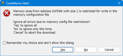

Hi NXP support team.
I using Codewarrior Version: 11.1
NMT88 EV board.
Bootloader:  PE multilink
When i loading hex file i meet  codeWarrior Alert " memory area from address 0xFD40 with size 2 is restricted for write in the memory configuration file"
What does this mean

I also encountered exactly same problem with example project from NXP, "NTM88_LocAngle_XZ".
This project contains data in FLASH of address 0xFD66 - 0xFDFF, the trim area.
Can we ignore these message?

Hello Windy,
I hope all is great with you.
The following response has been validated with one of our specialists:
Yes, it is normal. The warning informs the user that write and erase operations are prohibited on the trim page, in order not to erase or overwrite the trim coefficients.
So, just click “Yes” and go ahead with the programming.
In order not to see this message again, it is ok to tick “Remember my choice and don’t show this dialog”.
Please let me know if you find the information above useful.
David

Hello Quang,
This is because the trim coefficients are programmed by NXP between $FD40 and $FDFF.
Writing the FLASH memory is done byte by byte, but erasing it is done page by page. In the NTM88, a page is 512-byte long and the full FLASH memory contains 16 pages. The trim coefficients are located in the page that starts at address $FC00 and ends at address $FDFF.
I do not recommend to erase such values.
I hope this information helps.
David

QuangCa
Hi Vicentegomez,
Sorry for my late reply, i am in vacation of new lunar year in Vietnam.
I mean when i flash the hex file in to NTM88H055 IC,
I meet this alert  " memory area from address 0xFD40 with size 2 is restricted for write in the memory configuration file"
So i worry about this alert make my code run fail.
But i check with this alert, my program run normal.
I don't know this alert for exactly what warning? Can you explain more for this alert?
