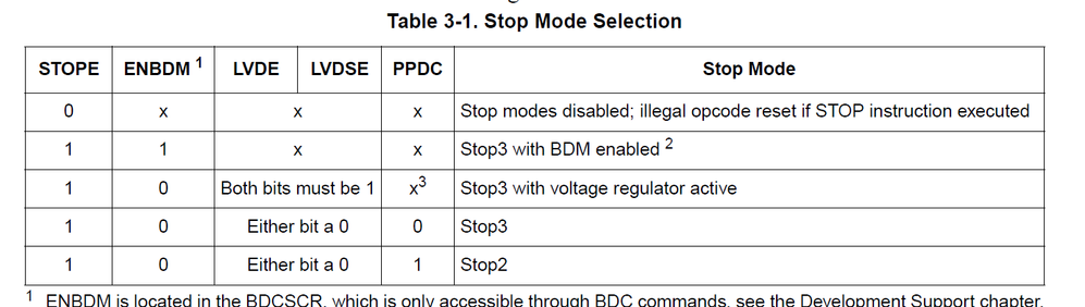

Hi Thomas
To enter to stop mode you need executing a STOP instruction under the conditions as shown in Table 3-1
Also check the WUPIE on MSCAN Receiver Interrupt Enable Register (CANRIER)
Vicente

Dear Vicente,
A big thanks for your quick answer.
Here is my implemented code, but it don't work.
The MCU spent ~ 13mA and the I can't try the Wake-Up-Iq
And I don't know why...

Thanks for your answer
Tom
2,025 Views
vicentegomez
Please remember that in some kind of stop mode, the debuger does not work, or if you are using the debuger probably you did not reach the stop mode
