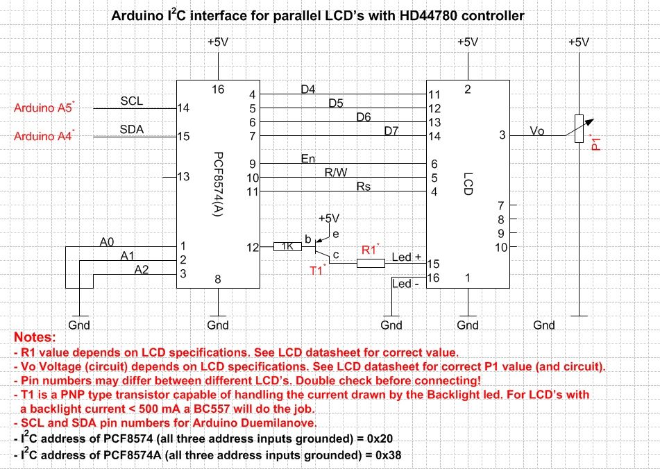

This would be the connection between the 8 bit I/O expander I2C bus and the lcd. In the picture refers to a Arduino instead of a MC9S08QG8 microcontroller, but the scheme is the same.

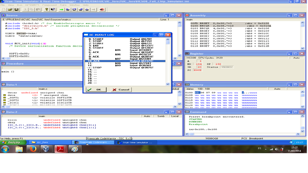

marmor
Hi weapon.
   I tested your code for the I2C communication and I have adapted to my microcontroller, the write function works fine, but on the function an error reading:
When multiple bytes are sent the last byte is not read and reads the next byte that sends the slave device (which should not happen because it sent the NACK bit) or if it does not send any more bytes the microcontoller reads $ FF and I do not know why it occurs. Any idea what may be going wrong?
I have attached a picture of the input and output data in the I2C module.
The slave device has to send 5 bytes with value $ 5, $ 6, $ 7, $ 8, $ 9, but the master device (microncontrolador) will only read the first 4 bytes ($ 5, $ 6, $ 7, $ 8), the problem is that it reads bytes $ 5, $ 6, $ 7, $ 9 and the microcontroller does not send the NACK bitI2C reading simulation.png
