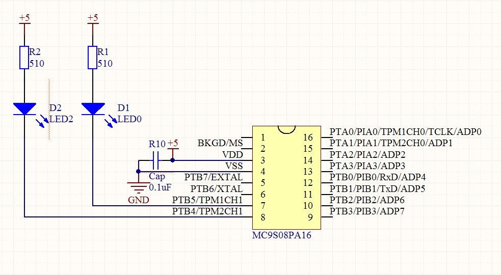

i have another problem...
when i power to the PA4,the led will flash,while? Because I program the PA4 find this problem,so i take the PA4 was no program..it also has this problem

This may depend on the POR threshold for the specific type.  When Vdd starts from zero, but remains below the POR threshold voltage, the I/O state is likely indeterminate, since the MCU hardware has not yet commenced to initialise.
Once the POR threshold is exceeded, the MCU hardware will be internally initialised, with I/O defaulting to inputs.  It would then require that Vdd exceed the the default LVD threshold before the clock would start, and code would commence to run.
To minimize this type of issue, the initial application of the Vdd supply should ramp up within a few milliseconds.
To protect against "brown-out", the LVD shold not be disabled.

I am using this port driver PNP transistors, but when I power up every time, because the port has a sink current pulses, causing the circuit to a PNP transistor opened.
No matter how I programmed PA4, power on, when the transistor is turned on, then off, and time is very short.
So I did not do this experiment PA4 programming, the phenomenon is the same.

The image of your schematic is correct? i don't see any transistor there.
If you don´t program PA4 the led turn on? and if you program PA4 with ports in default the led turn on too?

Hu, what happens if you ups the voltage to 5V?
In 1.7 V you are in Power On Reset (POR) range.
The circuit you are testing is the same of your schematic? I need to know that to help you, i can do tests with a board i have.
Regards, Burgos.

Yes,i use this schematic test.
if i ups the voltage to 5V,PTB4,PTB5 will have Sink current pulse!
