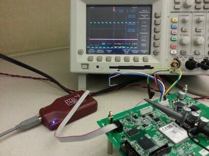

Now to exclude spurious interrupts I have changed the code to this.
#include <mc9s08pa4.h>
void main(void) {
  PORT_PTBOE  = 0x07;
  for(;;) {
  PORT_PTBD_PTBD1=1;
  PORT_PTBD_PTBD1=0;
I run the code as before. In Debug. Then I try to "Pause" and I get
No source available for "0x0000 (0x0000)() "
The code continues to run as the scope shows that the output is being turned toggled at about 616.5K but I have lost connection with the chip.
This is "VERY" repeatable.
From what I'm seeing I don't think this is anything I'm doing in software. Is there something wrong with my multilink? Is there something wrong with the chip I'm using?
Thank you for your help!

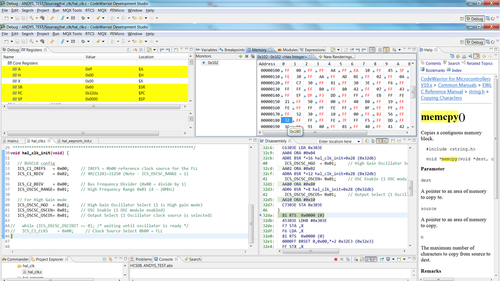

gregoryberardi
Hello Pavel,
I have an update and a little more information.
I got a TWR-9s08pt60 and have successfully got it debugging through the OSBDM. While debugging code that just initializes the clock, I was able to capture what is going on.  Please take a look at the image I have attached.
Thanks for all the help!
5,909 Views

CompilerGuru
I would recommend in this issue to start at the basics.
First, check if the reset vector at 0xFFFE/0xFFFE are reasonably programmed. Say point into the startup handler (and are not just 0xFF,0xFF).
Then reset the device and assembly step. Should be at the startup handler, and you should be able to see where the core leaves the expected path.
Make sure the code executed corresponds to the code to be flashed.
Note that the default setup for the debugger launch is to set a breakpoint at main and to resume the target. That's a nice behavior if the core reaches main....
But if something badly went wrong, say the app is not properly flashed, then I'm not surprised you see some strange code being executed when randomly stopping.
5,910 Views
gregoryberardi
Hello Guru,
I verified that the startup code was being executed. I also verified that 0xFFFF/0xFFFE is pointing to the beginning of startup. Please take a look at the image I posted and let me know what you think.
Thank you very much for your help!
