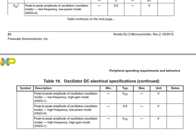

yangyu
Thanks for your support.
Yes,customer wants to know the Vpp for an external crystal signal such as kinetis mcu.
Please see below we can find the Vpp parameter in KL13 datasheet but no such parameter can be found in LL16 datasheet.
2,615件の閲覧回数
vicentegomez
Yes, for the S08 we do not have that spec
You can use the information that I shared in my previous post.
