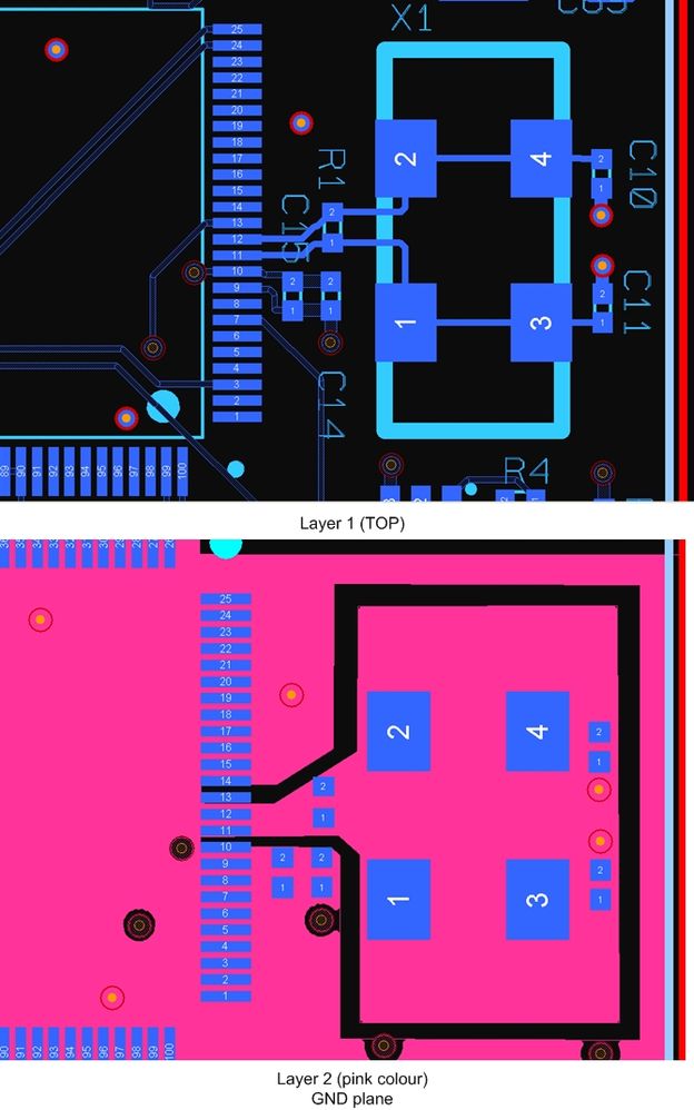

luis_alvarez
After tuning the capacitors and resistors, the microcontroller lock-ups diminished greatly in frequency but still happen every so often. Crystal has been tested in both "low-power" and "high-gain" oscillator operating mode, with "low-power" being almost an order of magnitude more reliable than high-gain.
I attach the crystal schematic and board layout to this message just in case it can be useful.
Schematic:
Layout:
1,911 Views
vicentegomez
Hi Juan
Please also check that the crystal is properly solder, and remember that the PCB lines also add some capacitance to the circuit.
Vicente Gomez

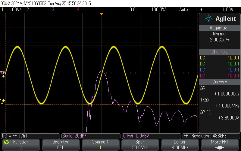

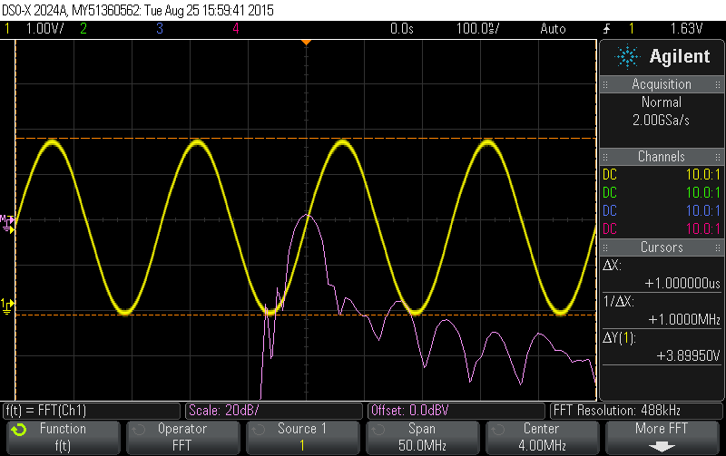

luis_alvarez
The Crystal seems to be working fine with the FLL module enabled or with both FLL/PLL bypassed. The output of the crystal when probed with a scope shous a stable 4MHz signal regardless if the PLL is working as expected or if it is unable to acqure lock.
Different boards built arround the DZ128 are having the exact same problem while boards built arround the DZ60 variant with the same crystal are not having this issue.
Scope probe on crystal output when MCU is working as expected. Pink trace is the FFT centered at 4MHz.
Scope probe on crystal output when MCU is unable to acquire lock. Pink trace is the FFT centered at 4MHz.
1,911 Views
luis_alvarez
Tuning the resistors seem to fix the issue. Will keep testing but it seems this is the correct answer.
