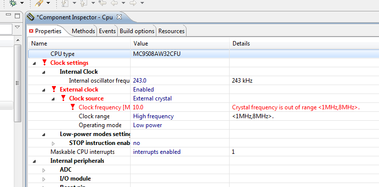

Problem choosing 10MHz X-tal
I have a project with a 10Mhz extern X-tal
On the freescale site I read   “32 KHz to 16 MHz reference external crystal/resonator”  ????
but in CodeWarrior The max freq. for this controller is 8Mhz
Do I miss something?

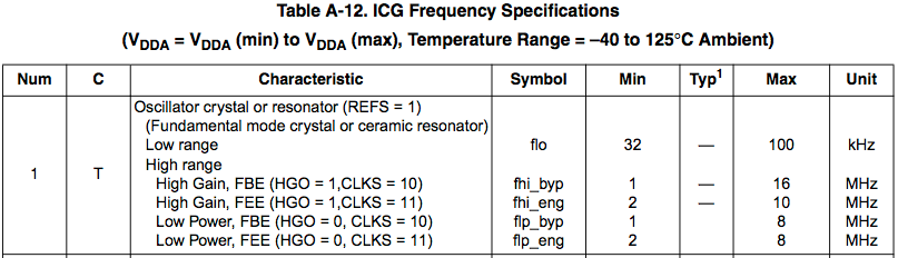

GordonD
Rob,
I don't really use PE, however, if you look in the AW32/60 data sheet in Table A-12, ICG Frequency Specifications, you will see that to use an external crystal greater than 8 MHz, the HGO bit in the ICGC1 register must be set (see below). So, I don't know if there's something in PE to select the "High-gain Oscillator" option. You'd think PE would do this automatically if a crystal frequency greater than 8 MHz was specified.
Gordon

robkeij
Gordon,
I'ts the first time I use PE and its look great,  have more experience with other controllers and IDE's. but no problem.
I can't find in the PE where/how  I can set de HGO bit, When I imported the project from PE 6.3 the frequency was set on 4Mhz.
but searching in de files I found:
this was generated in the old version CW 6.3 ;
    /* ICGC1: HGO=1,RANGE=1,REFS=1,CLKS1=1,CLKS0=1,OSCSTEN=0,LOCD=0,??=0 */
    ICGC1 = 0xF8;                      /* Initialization of the ICG control register 1 */
This generated in the CW10.5 version;
    /* ICGC1: HGO=0,RANGE=1,REFS=1,CLKS1=0,CLKS0=0,OSCSTEN=0,LOCD=0,??=0 */
    ICGC1 = 0x60;                      /* Initialization of the ICG control register 1 */
So you are right and yes I think the ICG1 setting are right generated if I make the right settings.
I have fount what I have to set in the PE  if I set Operating mode to High gain the clock range is changing to <1MHz,16Mhz>
So this is not changing automatically.......
Thanks Gordon for the information that lead me to the solution..
Rob
