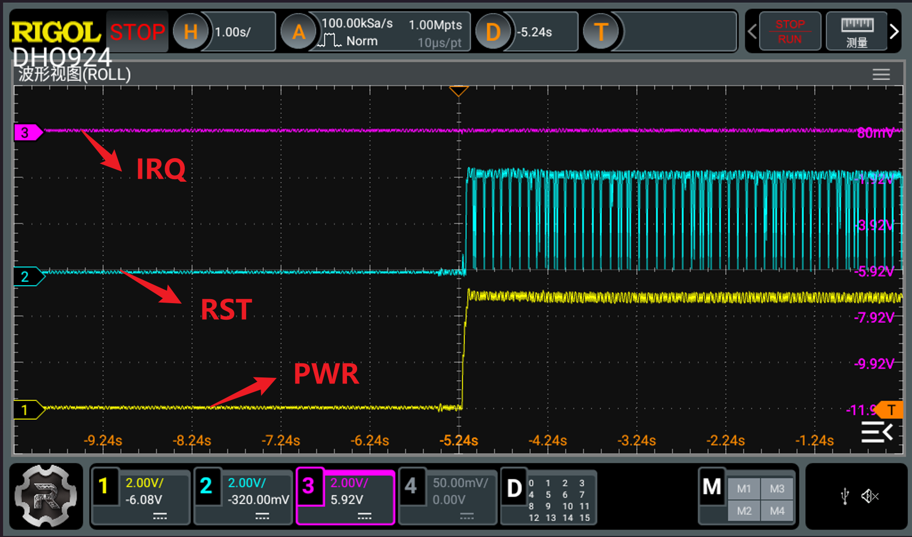

However, in June 2025 (a period of relatively high ambient temperature), we encountered a batch of failures where multiple MCUs could not bootload the program from the internal FLASH. Our failure analysis yielded the following observations:
1. Oscilloscope measurements of the MCU's RST pin showed that it was being pulled low repeatedly at intervals of approximately 32.85 ms, with a pulse width of about 5 µs, preventing successful startup.

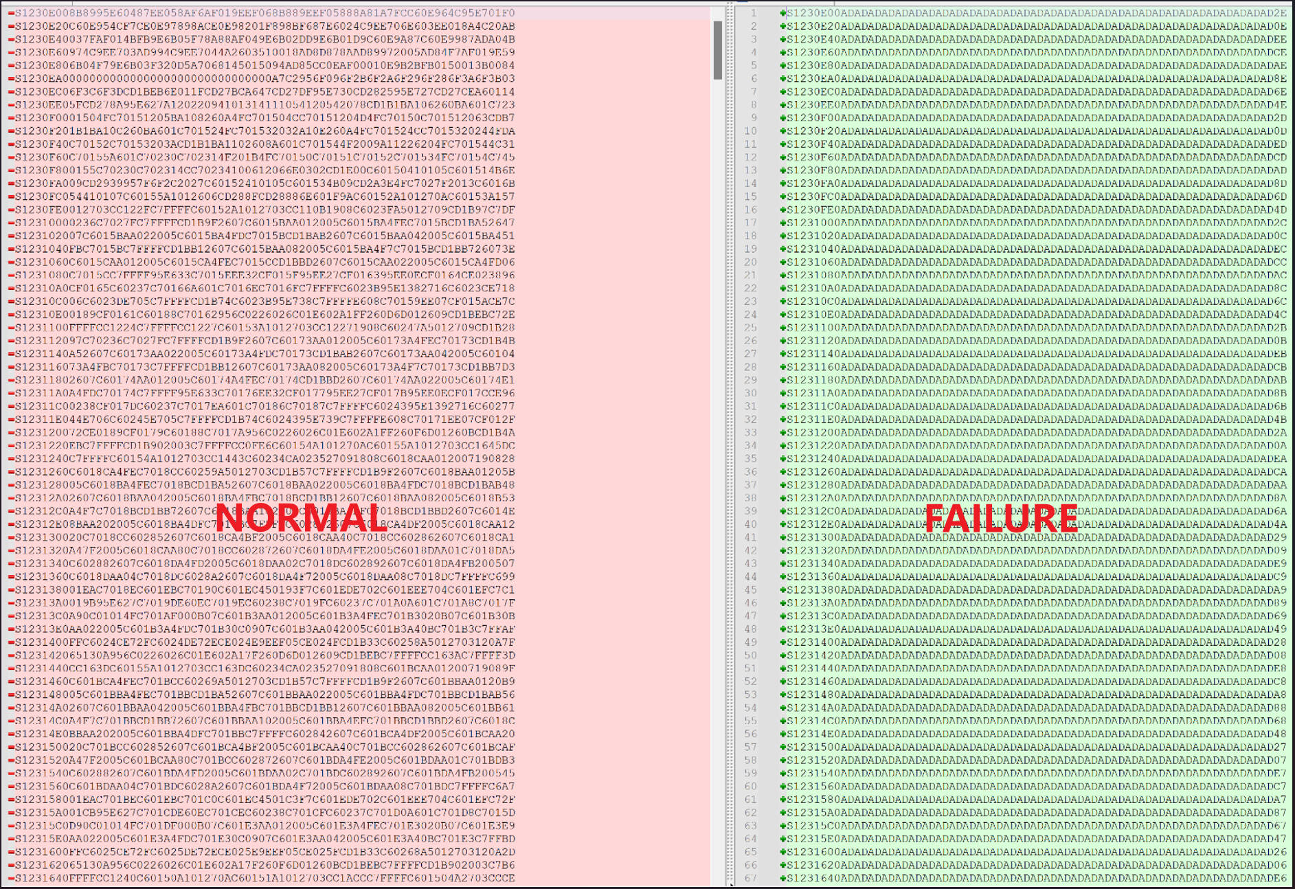

2. Using a Multilink Universal programmer, we attempted to read the memory content in the address range 0x0E00~0x8000. The readback data was consistently 0xAD across this entire segment.
3. The faulty devices were recovered by reprogramming the firmware using the emulator. After reprogramming, the units functioned normally and could successfully boot from the FLASH.

Please see the attached files. I have sent you the data readbacks (from address 0x0000 to 0xFFFF) of the Flash memory for both the normal and faulty boards. You can use Notepad++ to compare the data at each address.
