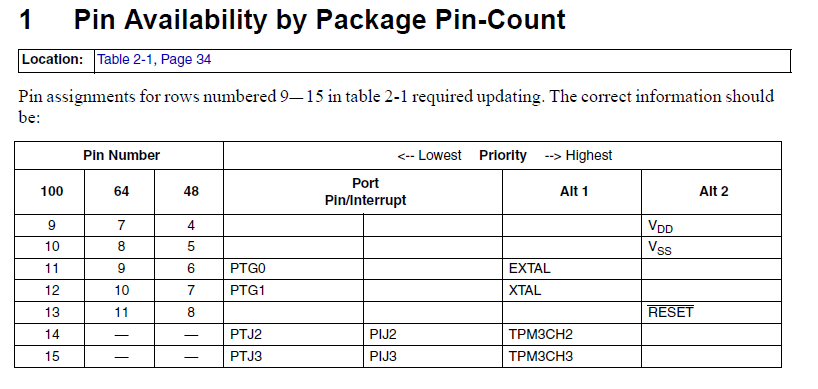

I have a doubt with the LQFP100 package of the 9S08DZ128. There is a difference in the Reference Manual in the pinout of the LQFP100 between de Figure 2-1 and the Table 2-1 in the assignements of the pins 9 to 15. Which is the correct one?

Hi please check the addendum
page 7
S08DZ data sheet
