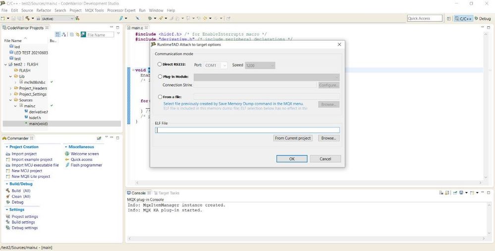

If the original firmware is not protected, yes you can perform an "attach" on CodeWarrior using the multilink.

I try program one chip and clone to another. Just for learning.
It's not protected. In codewarrior i choose MAC Tools -> Attach to target. But not have USBD programmer to choose. :(. Whats i do wrong?
