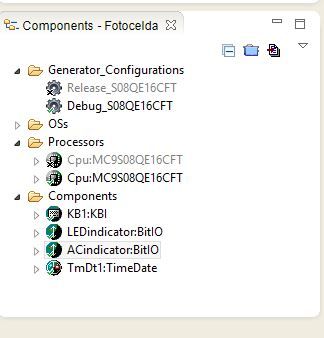

Hello Everyone.
Recently I was assigned a project. But to achieve that project, I need to make the MC9S08QE16 go below to 4uA with a extern RTC.
Currently I was able to achieve 25-22~uA with RTC and 8-7.5~uA without RTC.
I had read a lot in the forum but I cannot make it go below.
I will attach some picture and the code.

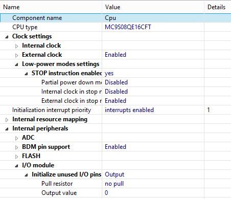

Processor Expert Components:
Processor Expert CPU config:

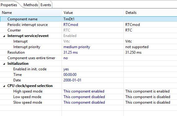

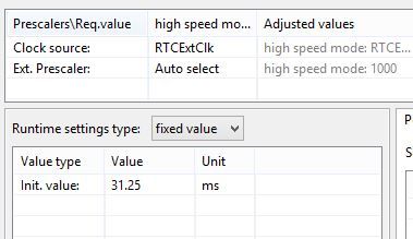

RTC config:
  1. LVD module is disable in Stop mode.
  2. All unused I/O pins were set as Output and default value 0;
  3. ADC module is disable.
Thanks for advance.

I don't know if you're already doing these but, if not, you could try:
* Turn off the various unused peripherals (like, for example, the SCI).  Turn it off means, in most cases, writing the default reset values to the related registers.
* Turn off all clocks to the various peripherals (that you don't need).
Order matters so you should first turn off, say, the SCI, and then remove its clock.
[Note: It's been a really long time I had to do this but I think that shutting off just the clock (say, to the SCI) did not reduce consumption as much as first turning the SCI off, and then its clock.  I could be mistaken about the exact details, because it was many years ago, but there was some little quirk like this that took me a while to figure out, and it alone dropped consumption to acceptable levels.]
Hope it helps!

Note: SCGC2 = 0x04, because if I disable the RTC the current consumption goes up to 6 mA.
Right now with this set and the RTC clock enable it's consumption is 24-30~uA in stop3.
Do you any other suggestion?
