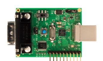

Hello Andrew,
Unfortunately the MC9S08QE32 does not have USB module.
In case you are planning to use the device mentioned, I recommend the USB2SER board.
The USB2SER board is a communication bridge between the USB and serial data, which can be any RS232/RS485 or TTL.
Please find more information about the USB2SER in the following link:
http://www.freescale.com/webapp/sps/site/prod_summary.jsp?code=EVBUSB2SER
Hope this information will be useful for you.
If I misunderstood your question or you still have concerns, please, do not hesitate to contact us again.
